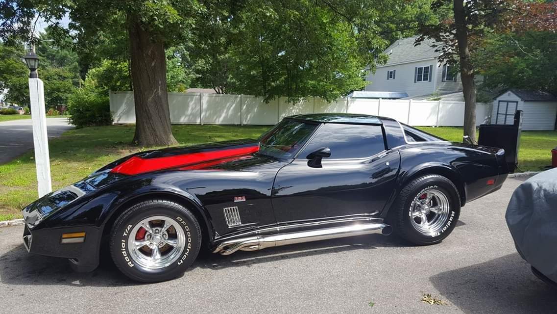

Thanks! Started as this when I was in high school. I do all my own my wrenching
