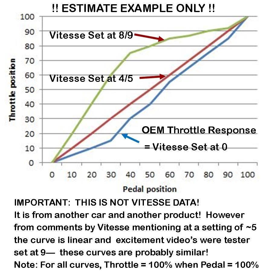

Originally Posted by Maxpowers
It doesn't correct it (like a ported TB) but it does mask it by giving you the option to have the accelerator linear. JerryU has a diagram that provides a good visual. You may want to search for that.
Thanks, a bit hard to describe in words but theses graphics may help. Vitesse "improved" the slow tip-in the C7 has in Touring Mode. It my case always drove my 2017 Z51 none MRC in Track that had the fastest tip-in. My Grand Sport driven in Touring was slow and I set my Vitesse at 4/5 that was about what I had for 3 1/2 years. With the MRC upgrade I drive in port and Vitesse is not needed.
The Throttle body porting decreases the time it takes the flow rate to increase AFTER the throttle body is fully open! It doesn't occur "instantly." Still can't with a ported throttle body (similar reason you see lightening before you hear thunder) but the time can be reduced!

Jerry you seem like a very smart guy and your input is always something worth reading .
However I think your graph that you keep posting is a bit misleading to say the least .
Basically my seat of the pants experience with V
the vitesee thing is nothing like your graph shows .
There is nothing linear at all about using one of those electronica throttle controllers it actually does the exact opposite of are you eating a “linear “ throttle pedal feel. Also at parking lot speeds I got A fair amount of stumble and jerky experience with the vitess set at 4 or 5 like most guy seem to like. They simply don’t correct the real problem .
From my experience a ported throttle body is the only thing that has Created a more linear pedal , and reduced the tip in lag or stumble or whatever you want to call it .
Lots of opinions on here about this stuff but I just see them as being two completely different animals,
Yep two issues!
The first is GM and most manufacturers build a slow tip-in, i.e. ~30% throttle pedal provides only ~15% throttle body butterfly opening. That is why not only Vitesse but others are successful selling devices that get ride of the slow tip-in. That graph is NOT one I made, as I note, in fact Vitesse does not provide the graph! It is from another manufacturers device but the labeling is partly my observation from driving my 2014 in mostly Track Mode (it was a none MRC so no issue with ride quality) I had the maximum throttle response offered by GM.
Vitesse states when set mid way, 4 or 5 their device provides a linear pedal to throttle butterflies response so that is what I show and found. I tried 9 and it's more like that top line. Also comments from many forum posters make me say it's like Boy Racer! Note all setting at 100% Pedal are 100% throttle- it's just how they get there. Many posts saying it's effective as IMO it is to REDUCE THE SLOW TIP-IN BUILT INTO THE C7 IN TOURING MODE.
When I got my Grand Sport I was driving in Touring to get a ride similar to what I had with my none MRC Z51. Sport was stiffer (validated by comments from Tadge!) Particularly from a stop that slow tip-in was NOT what I was used to. So added the Vitesse and it accomplished what I wanted. I was able to set it up so it was similar to my 3 1/2 years driving my Z51.
When I got the MRC upgrade I now drive in Sport where the GM tip-in is faster (see tables below from the Owner's Manual. I don't need the Vitesse and in fact don't use it!
Bottom Line: Vitesse and similar devices do what in the C7 does depending on drive mode, but adjustable in any drive mode!
The Throttle body mods decrease the time it takes for the air flow to reach max flow at WOT after the butterflies are open. Not by a lot, as the Katech graphs shows for an LS3 0.028 seconds. But that is perceptible.
PS: I never had a stumble or problem at slow parking lot speeds. There was info about an issue with the variable resistor not being properly connecte to the **** on some units! It affects calibration. If you want to contine to use it, suggest finding those posts or sending your unit back to be corrected.

Jerry Here again you post another graph which to me is completely useless .
Wile driving my 2018 m7 z51 There is absolutely no difference in Throttle response between tour , sport or track. Absolutely none that I can detect.
Is is that graph only Applicable to A8 cars or mag ride cars???
Hmm, no way. It is from the C7 Owner's Manuals for all cars. I have an M7 and definitely felt the difference in my 2014 none MRC Z51 as well as my Grand Sport with MRC.
