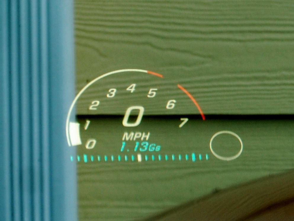

Missing segment at 2 o'clock

What is peculiar is, the '5' is now whole.

Dealer determined that part of the line that projects the image is not lit. The HUD is being replaced. The gmepp warranty has now paid for itself

Parts were missing in every selection except the screen that only displayed speed. The speed was outside the dead area.
Not looking forward to them removing the dash.
