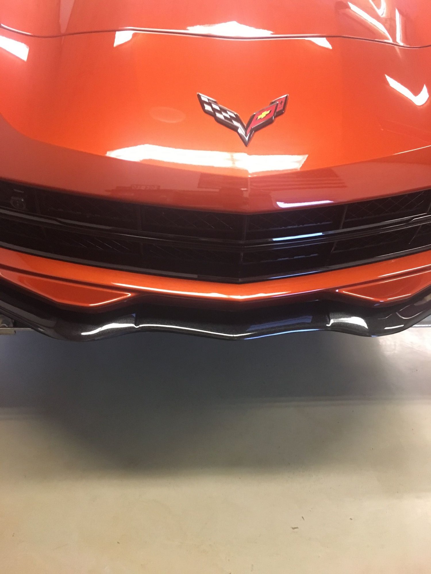

I got mine from C7 Carbon. It used the existing bolts. Installed in less than half an hour.

C7 Carbon also. Easy install using factory screws

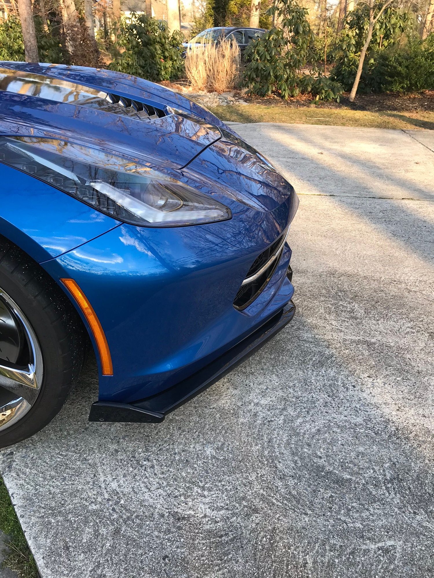

I bought my poverty splitter used. Used the 12 (I think it was) factory screws. It was very easy and felt reasonably secure. I decided to also drill right through the rivet holes in the splitter (1/4” bit). Picked up the plastic push-pin “rivets” at Lowe’s which easily popped right in. Very secure now:
Good luck — nice, cheap, easy mod.

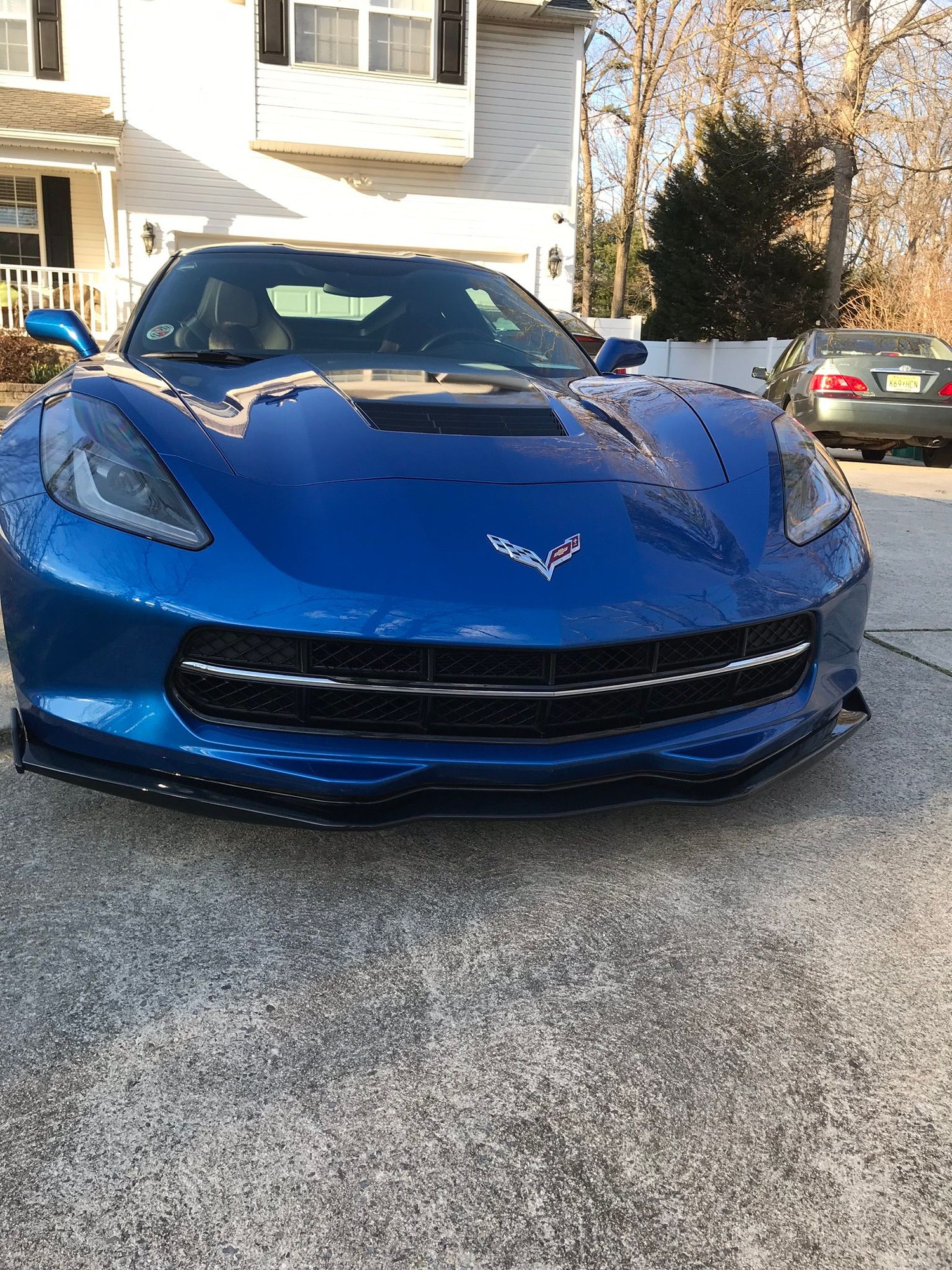

Installed RPI, used existing and added additional screws too, pretty easy.

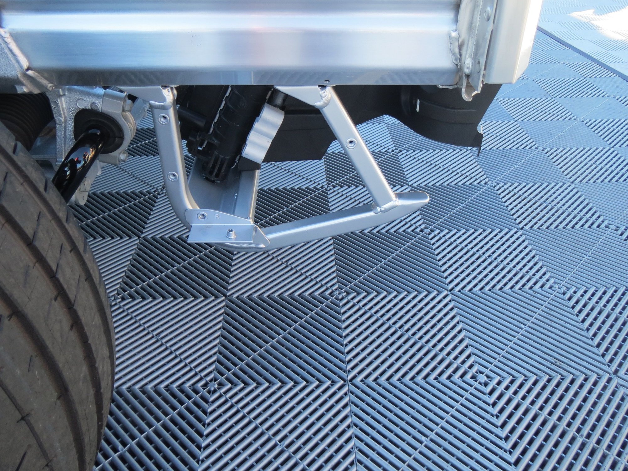

They came installed with my Grand Sport Stage 2 Aero Option that has the Stage 2 Winglets. I replaced those with Stage 3 Winglets and left them on.
In addition to diverting some air around the high drag wheel well opening they provide an early warning the next thing to hit are the GM radiator supports that also act a "skid pads." If you ever hit those aluminum tubing "skid pads" on pavement, makes the air dam scaping sound like "music!
