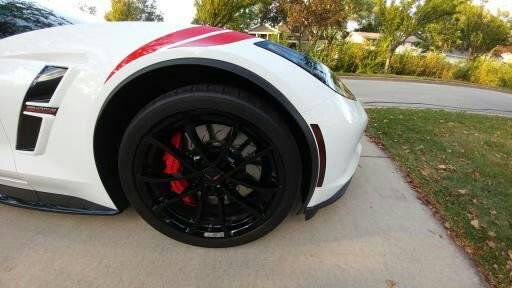

Hi guys, my 2019 Grand Sport has the black wheels with stock chrome lig nuts. I would like to change to black lug nuts. Can you tell me the size/shape and any recommendations?

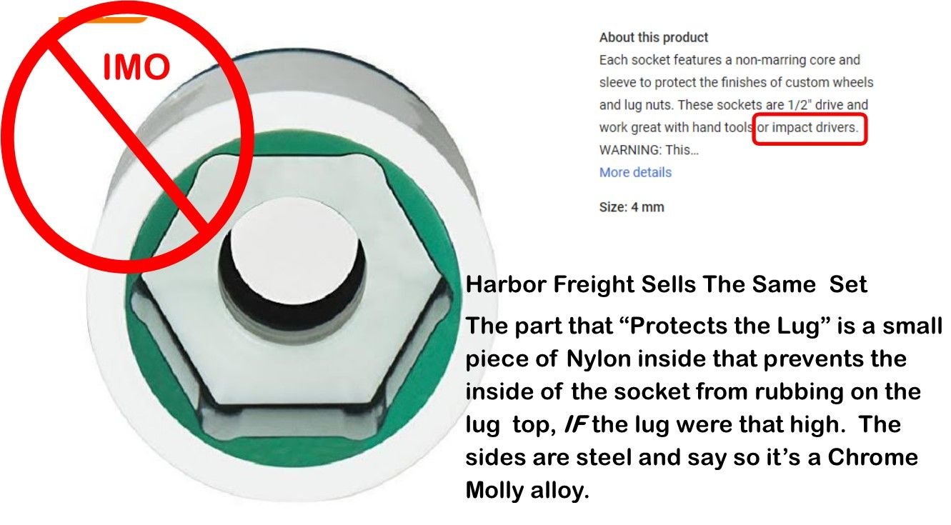

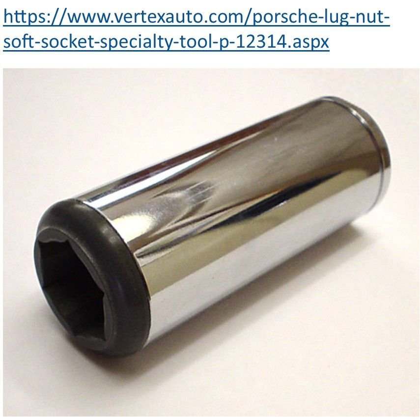

None Maring Scoket
As far as a socket that won't mar the lug surface, have used the one shown below for 10 years on my C6 Z51, C7 Z51 and my current Grand Sport. It has a hard plastic insert INSIDE not the cheap ones sold that say "no maring" BUT only have a thin plastic outside to "protect the wheels" but do nothing for the lug nuts! I get upset at the marketing pitch for some that don't say it's only for the wheel. Some even have colored insides that don't look like steel- BUT THEY ARE- use a magnet! The colors are for a mechanic using an air powered wrench and have nothing to do with reduced maring of the lug!
If I felt I needed to protect the wheel I would just wrap my socket with electrical tape! BUT it can only be used with hand tools and a torques wrench NOT an air wrench so the socket doesn't touch the wheel. In fact I can't see how an air wrench is appropriate as I always use a multi-step torque approach just like I do on a cylinder head! In fact on my street rod I had a slight vibration when braking that went away when I used a three step torque approach. I typically use a ratchet with my socket to tighten all lugs, then my torque wrench set at 75 ft-lbs, and tighten in a cross pattern, then repeat with 100 ft-lbs. If I have the wheels removed by a dealer or tire shop, I request not to use an air wrench to tighten (some are set too high) and still come home, loosen and retorque that wheel!
The socket I use is NOT cheap. That link I just found is from a Porsche aftermarket shop BUT I have not been able to find a cheap source. Might search.

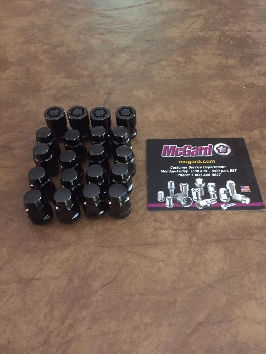

I bought these.

They look like the 64015 lugs that I used with locks!

Originally Posted by bbrown450
Whats the preferred socket with an insert to protect these for install ? I purchased some black lugs a couple of months ago and failed to purchase the socket ...thanks in advance
The one I have the pic of in Post #10 is best. Not cheap but I have had mine for 10 years. If changing tires or brakes often as when Tracking, it would wear.
Most others say they "Protect the Lug" but only from something that doesn't happen in most cases "from the inside of a socket hitting the outside TOP of the lug." Does nothing for where the wear occurs which is on the sides of the lug! The inside color is deceptive! It's for sets sold so a mechanic using an air wrench can pick the correct socket quickly. The one I use has ONLY plastic hitting the lug, it clearly says cannot us with an air wrench. As I note in post # 10 the correct way to tighten a wheel is in steps anyway so ~two torque settings should be used!
If you don't want to spend the money could do what I did (and many do) for my Vettes prior to getting this socket. Get a box of sandwich plastic bags, cut so you have only one thickness of plastic and put it over the lug before slipping on the socket. Usually get 2 or 3 lugs done before it will wear a hole and you need another piece!
