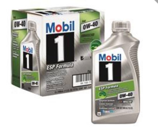

I don't think you are buying the Corvette stuff guys! Walmart now sells it in 1 qt bottles: Mobil 1 ESP Formula 0W-40 1Qt

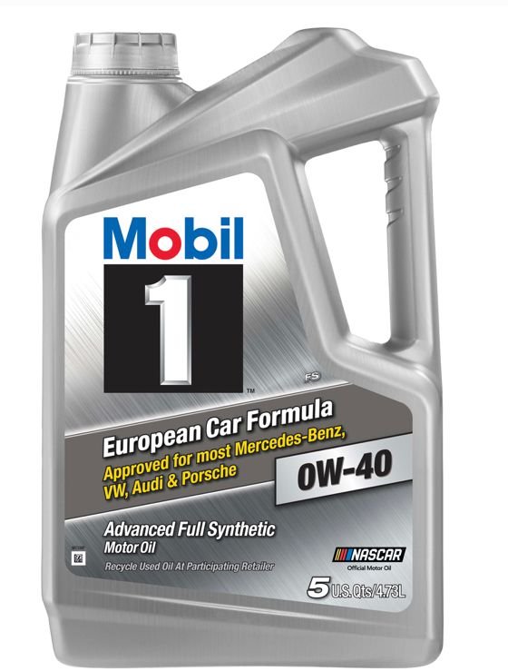

I agree
here are pics of the wrong stuff “European Formula” above and
The right stuff “ESP” below.

The ESP has less of the good stuff (metals) correct?
I like the good old 0W 40 Euro
The Euro version has too much sulfated ash (1.34%) compared to 0.8% for the ESP Formula 0w40. That extra level of SA will contribute to higher levels of intake valve deposits, so it's really not an oil you want to run long term in the LT1 or LT4 (or any other direct injected engine you might own)
Interesting, i was not aware, thanks
Not quite correct. The higher sulfated ash can possibly contribute to slightly quicker deterioration of a diesel particulate filter or catalytic converter over an extremely long period of time. Many manufacturers still use the Euro version 0w40 as a factory recommended oil with direct injected engines, Porsche is an example.
You will very likely not ever notice a difference or see any problems substituting the euro 0w40 for the ESP version.

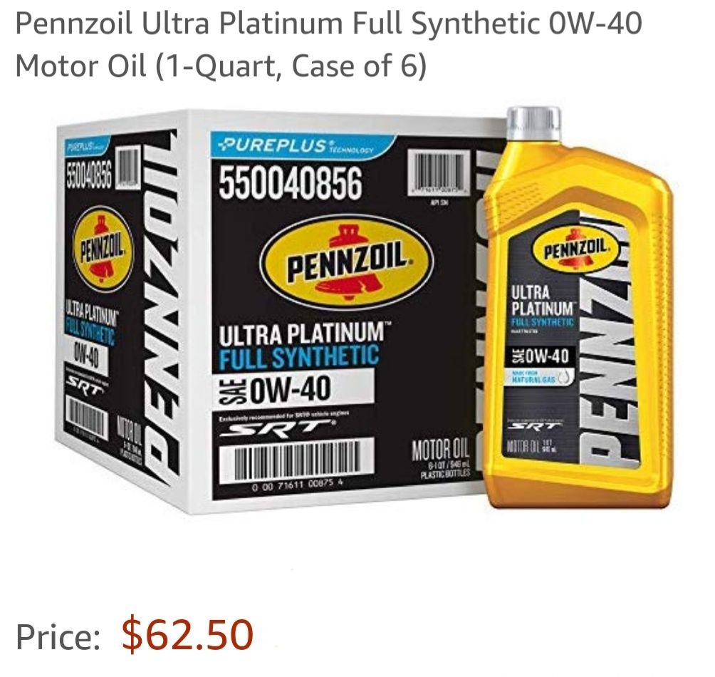

Pricy?
Dodge recommends 0-40 Pennzoil for it's 6.4L Hemi.

Originally Posted by VNAMVET
Pricy?
Also the recommended oil for the 6.2L supercharged hemi in the Hellcat. I get 8qts plus an SRT filter off ebay for around $80 shipped for my Charger HC..
