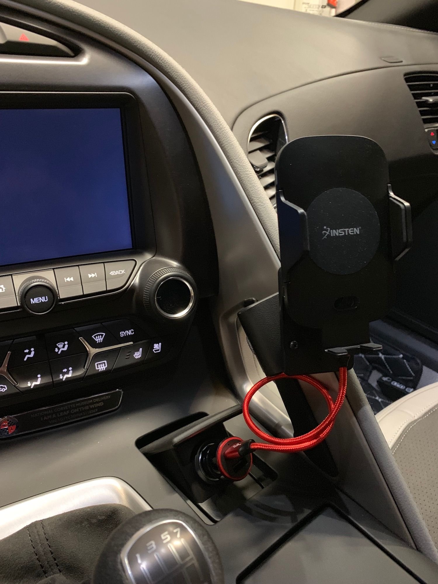

I went searching for a wireless charging mount for my iPhone XS Max. I found this ‘automatic’ mount on Amazon;
https://www.amazon.com/Wireless-Char...70_&dpSrc=srch https://www.amazon.com/Wireless-Char...70_&dpSrc=srch
One handed operation, since it opens automatically via a motion sensor. Cool!
Works for iPhone X/XS Max/XR/8 Plus/Galaxy S9/S9+/S8+ LG G6/V30. Fits my iPhone XS Max perfectly. Here is a Youtube that shows it in action;
(The audio announcement you hear is my Blackvue dashcam. This install is on my 4Runner, but I have thesame setup in my Corvette)
This mount came with a vent clip style mount, which I did not use. I combined the following;
- my existing Proclip base mount
- an extension plate (Proclip) which already had
- an angle block (also from Proclip) just to angle the phone towards me a little bit
- and a small piece of sheet metal
I drilled holes in the right places on the sheet metal to mount to my existing base, and then drilled a 7/8 inch hole to accommodate the Insten mount. The 7/8 hole needs just a small amount of filing. On the back of the Insten mount there is a round threaded post, and a plastic nut is on the vent mount. That is how I attached the mount to the sheet metal. See pics for more detail. The nut is held to the vent clip that you need to cut off. Cut where the red arrows are in the last pic. Keep the nut, throw the vent mount away.
I'm happy with the result, and love the cool factor. The holder grips the phone firmly, but if you shut off the car, you can still remove the phone from the mount without power.
- Proclip base mount
- a small piece of sheet metal
Pics from the same setup in my Vette;
I like this set up. Any issues with it being too sensitive and dropping the phone?
Sure seems very solid. My 4Runner is a pretty stiff ride, never had an issue. The again, not going offroad or seriously road racing, so... Yeah, it holds the phone firmly.
Maybe it's me but I don't get the "wireless" part. You have your end clip wired into the same port that I use for my wired set up. The only difference I see is your set up has the other end going into the phone holder while my wired set up has the other end going into the phone.
What am I missing?
Old Jan 11, 2022 | 07:51 PM
aklim's Avatar
aklim
Joined: Jul 2004
Posts: 28,430
Likes: 3,281
From: Hartford WI
What am I missing?
Not so bad with the USB-C but with the older USB, sometimes the plug end wears out. Also you have to get it in just right or you might damage the port on the phone. This way, I don't have to plug it in. Just drop it on and it charges. Much easier when it is dark.
