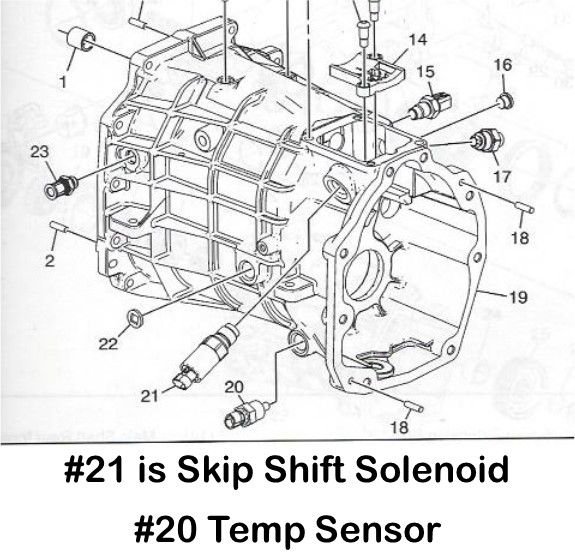

Here is a pic of where it is on the left side of the trans. Don't confuse it, which is near the top with the temp sensor that is on the bottom. Connectors are different:

^^^ That would have helped . . . and I do my own oil changes. Actually, GM improved the thermal insulation on the wires, so I got under the car and it did not look quite right. But a different thread here on the forum showed me what to look for.

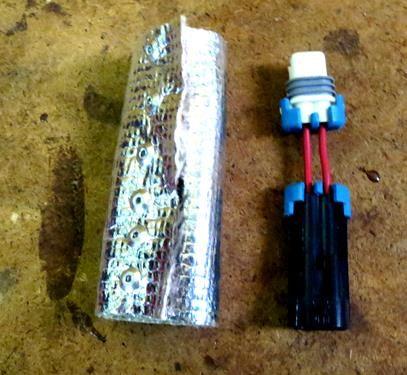

The one I bought has two connected plugs BUT that is just for installation purposes.
The connector that goes into the Blocking Solenoid is there to only keep out dirt! The plug that connects to the wires that go to the car is the one that has the proper value resistor to "fool" the computer thinking the solenoid was activate. Some have two separate plugs, which work the same! The wires that tie the two together are NOT electrically attached to the plugs!
Note, I made insulation to cover mine just because it is close to the exhaust pipe. Really not needed if you use a couple of plastic ties to keep it from hitting,
