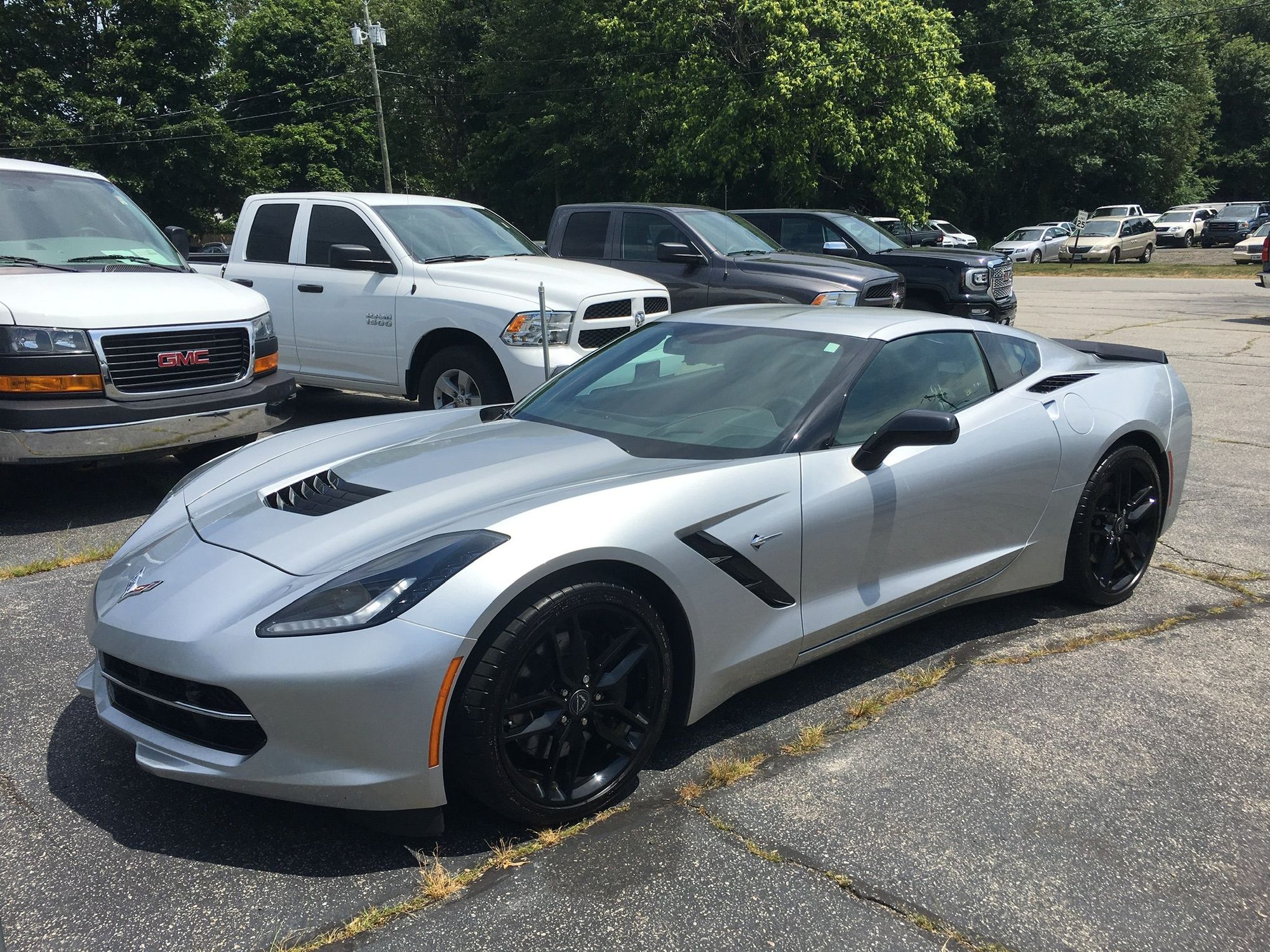

I know this may be a dumb question but just got 2016 z51 stingray coupe and trying to get old owners seat memory settings gone and mine in. I do what manual says and it just goes to first owners stuff. Anyone can help me?
New ride 😀
