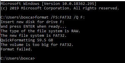

This is what I get.....current mat is exFAT. Pwershell and CMD give me the same thing....Help!
Thanks in advance

It looks as if Microsoft has disallowed formatting of FAT32 on larger than 32 gig drives. It was possible in the past but not anymore. I tried both in Powershell and CMD and they did not work.
Third party software is the way to go now.

I thought /Q (Quick Format) was the problem. Nope.
C:\Users\Ron>format /FS:FAT32 E:
Insert new disk for drive E:
and press ENTER when ready...
The type of the file system is EXFAT.
The new file system is FAT32.
Verifying 59.5 GB
The volume is too big for FAT32.
Format failed.
Time to get a third party format utility.
Ron
