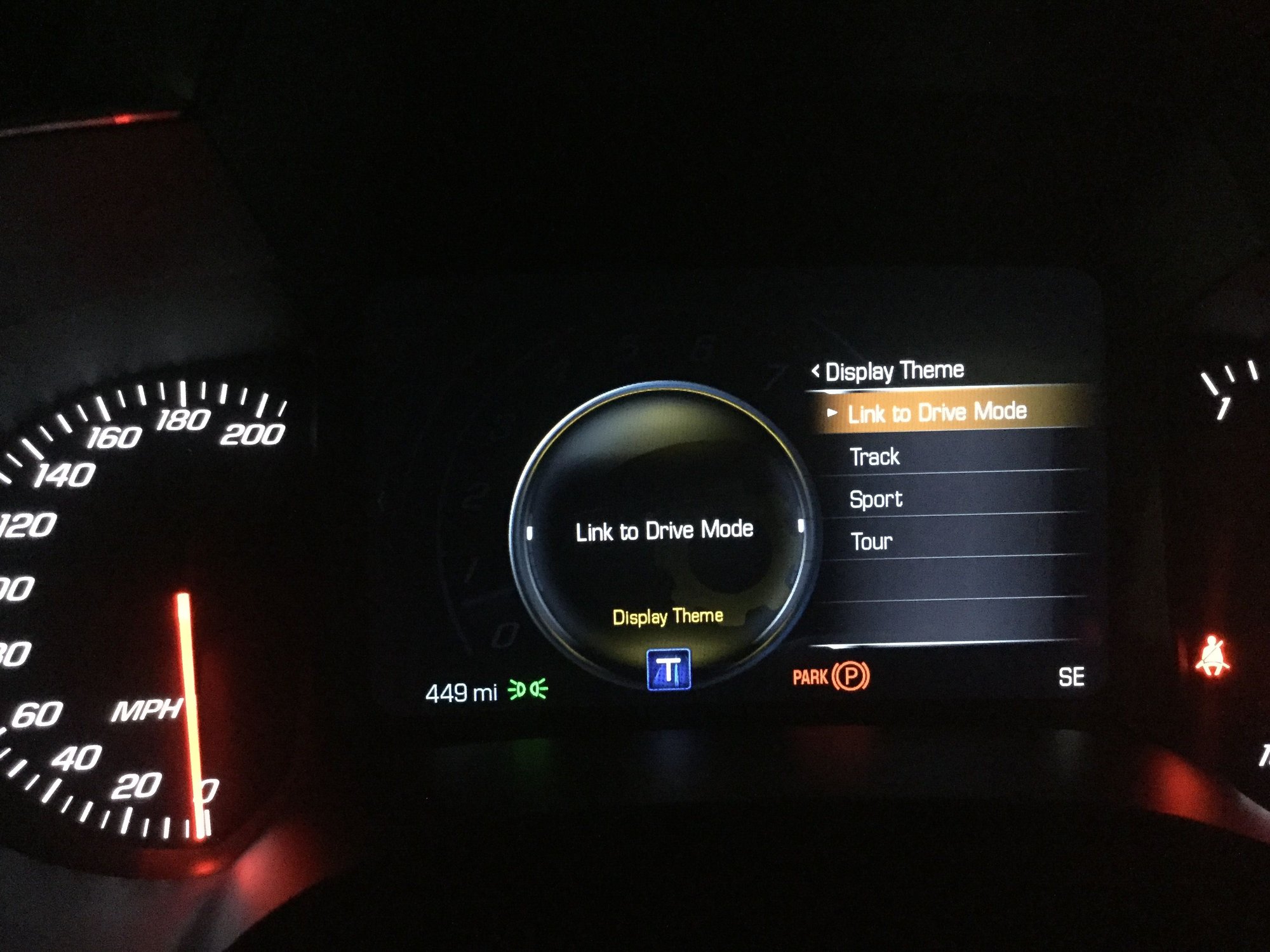

I think what you are talking about is you want the driver display to look like it is in sport mode but have the touring suspension on. Yes you can do that. On your steering wheel hit the left arrow next to select and scroll down to options. Hit the select button and scroll down until you see something about sport settings and then hit the right arrow button and you should see this screen. Scroll to sport setting and hit select and your car will stay with that screen but you can change the suspension to anything you want at anytime.
