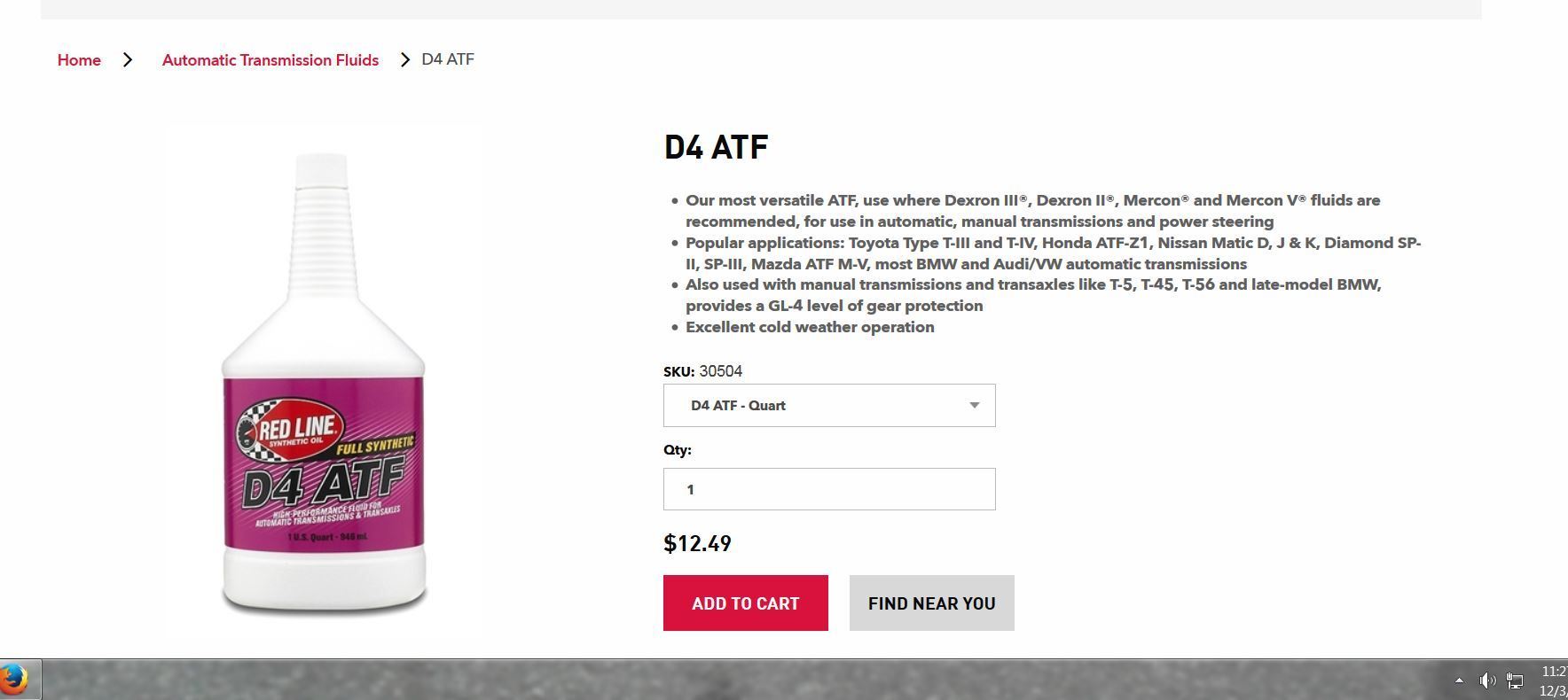

Change the fluid to redline d4, big difference. The factory fluid is not so great. Also check clutch cylinder.

I changed fluid to Redline D4 and it helps. Also did the differential fluid at the same time. While the old transmission fluid looked new the differential fluid did not with 12000 miles. The shifts improved. I seldom get that notchy grinding feeling now.

Just to make sure I use the right stuff this is what you guys are talking about?
