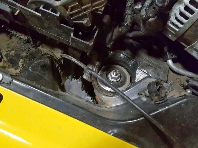

I'm about to buy this 16 Callaway with some damage and salvage title but not sure what to make of the damage. It appears someone slammed into a curb and destroyed the wheel (not sure whats up with mirror) since bumper and fender aren't crushed. Rest of car seems fine. Do you guys think this is a 5k fix, 10k fix or more? My bet is 10K but i'm far from an expert. I figured it'll be a fun winter project to repair and save me some cash from buying the 2020 Z51. Unfortunately photo's are all i have but says 18k miles and runs and drives (although obviously doesn't drive the wheel is messed up).

Your whole front end is shifted and likely a lot of right front suspension damage- Im not familiar if the frame extends that far forward but probably will be bent as well. The front clip seems grossly unaffected but the front quarter panel is deviated. Mirror was collateral damage. There was a reason the insurance company salvaged it. Your not fixing that for 10k or perhaps even at all

Impossible to say without removal of engine and all components to assess frame damage. You could get lucky if you are capable of DIY, but in all likelihood, it's not worth it.

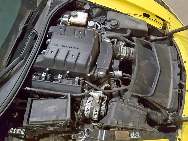

Forgot the other engine pic. Damage seems isolated to right wheel area. In my experience insurance will total anything that doesn't fit their estimating software box.... like no callaway option. Also with cars like this many wouldn't want theirs to just be repaired but replaced so i'm not too concerned with the status of salvage as far as determining damage. Not sure of value its so hard to see callaway's for sale and even more rare for the SC627. Comparing to Z06 i'm thinking $50K would be fair value in great condition so $40k seems reasonable for a repaired salvage, especially for something someone might use as a track car. I'm still negotiating but it'll be something like $25K ballpark and another 10K for repairs

Anyone have a pic of what it should look like? I can't really tell if that's fiberglass holding the shock mount or if its bent steel that might be bent back. I've been driving a 17 GS but won't get back until next week or two.

The front fender mounts to a plastic piece that is glued to the frame. It looks like the frame in that area is bent causing that plastic part break. There has been some penetration into the engine compartment that has affected the underhood electrical center and it looks like the alternator mounting bracket or ears are bent/broken. I would assume one of the control arms is bent. Actually the fender and front fascia look like they may need painting at the worst. There are replacement parts available from GM to repair the frame. They come in three different pieces. One part replaces the very forward part of the frame and the other piece replaces the part the first one attaches to the third part replaces those two plus the side rail.
As for a control arm being bent I would assume the upper control arm, lower control arm, knuckle, wheel bearing/hub, tie rod, maybe power steering unit would need replacing as well.
The issue with repairing the car is more than likely one of parts availability and labor cost. There will be a fair amount of labor involved in tearing down the car far enough to take the frame apart and then weld it back together with new parts so it is straight then gluing on a new fender mounting part. The rest of the parts are all bolt on parts and not all that difficult to remove/replace. I bet you are looking at between $20K-$25K to put it back to like new condition which can be done. These cars will take a substantial hit and after being repaired be no worse for the wear.
Bill
Thanks this is exactly what I was looking for. I'm really concerned how the shock and control arms connect to the vehicle.
