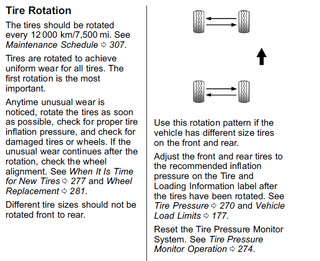

The manual is your friend.
Side to side is the only rotation due to the tire sizes, and so recommended in the 2017 manual, P276:

It's interesting that the manual section cited above says to rotate the tires and references page 307 but that section does not specify rotating the tires.
