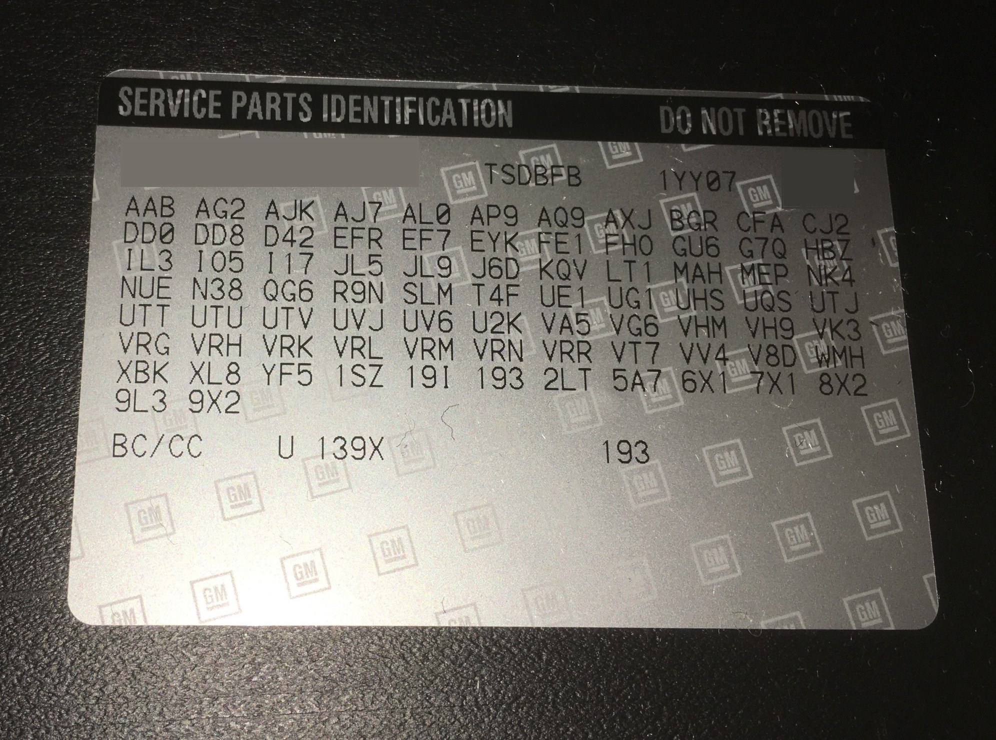

Thanks! Is your original RPO code IO5? Digital Dash advised that there were different RPOs for non nav C7s, which was a surprise to me, but may not apply to the '19 model year.

Thanks for explaining the speed limit signs. That explains it. Was driving myself mad trying to figure out why it was not displaying. How can I tell if I had io5? My module I pulled says NG 2.5 HMI model number on it if that tells you anything?
The RPO codes for the car as built are on a label under the cargo compartment carpet to the left of the battery.
The carpet is difficult to lift for access and some owners suggest partially removing the lower side of the RH trim piece, but I was successful being careful and taking my time...
