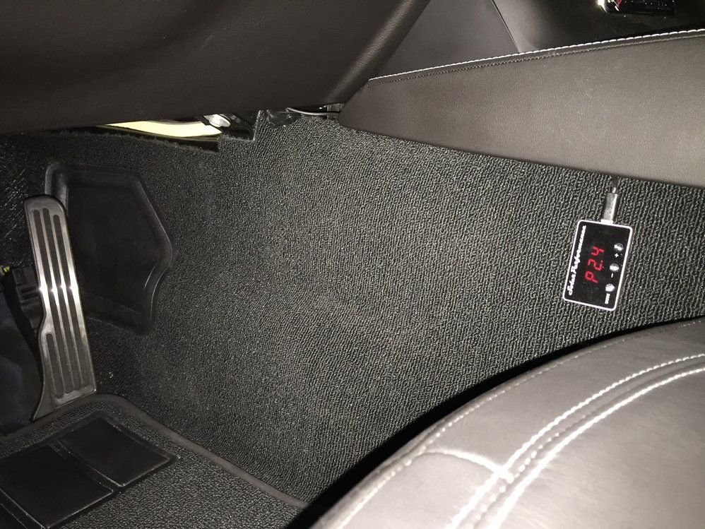

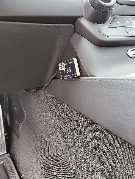

Where and how do you mount the Soler throttle controller control panel? Pics appreciated.
And does this affect warranty in any way? Disconnect before any dealer visits? Thanks.

Yeah i can get pics for ya tomorrow. I have mine mounted just below the start button. they come with 3m adhesive on the back.
10m socket to remove pedal, Soler TC plugs in line, run it through the carpet behind the pedal(super easy, carpet is not glued down and easy to run through opening. I tucked the excess wire behind carpet and mounted.
Soler Provides great instructions with pics too! (10 min job)

Here’s pics of it installed underneath the carpet behind the gas pedal and the controller wire tucked behind the trim piece...

I did something similar to the above but I just velco'd the controller in place (easy to pull off and drop behind the carpet again for trips to the dealership).

Many thanks for the photos. David
