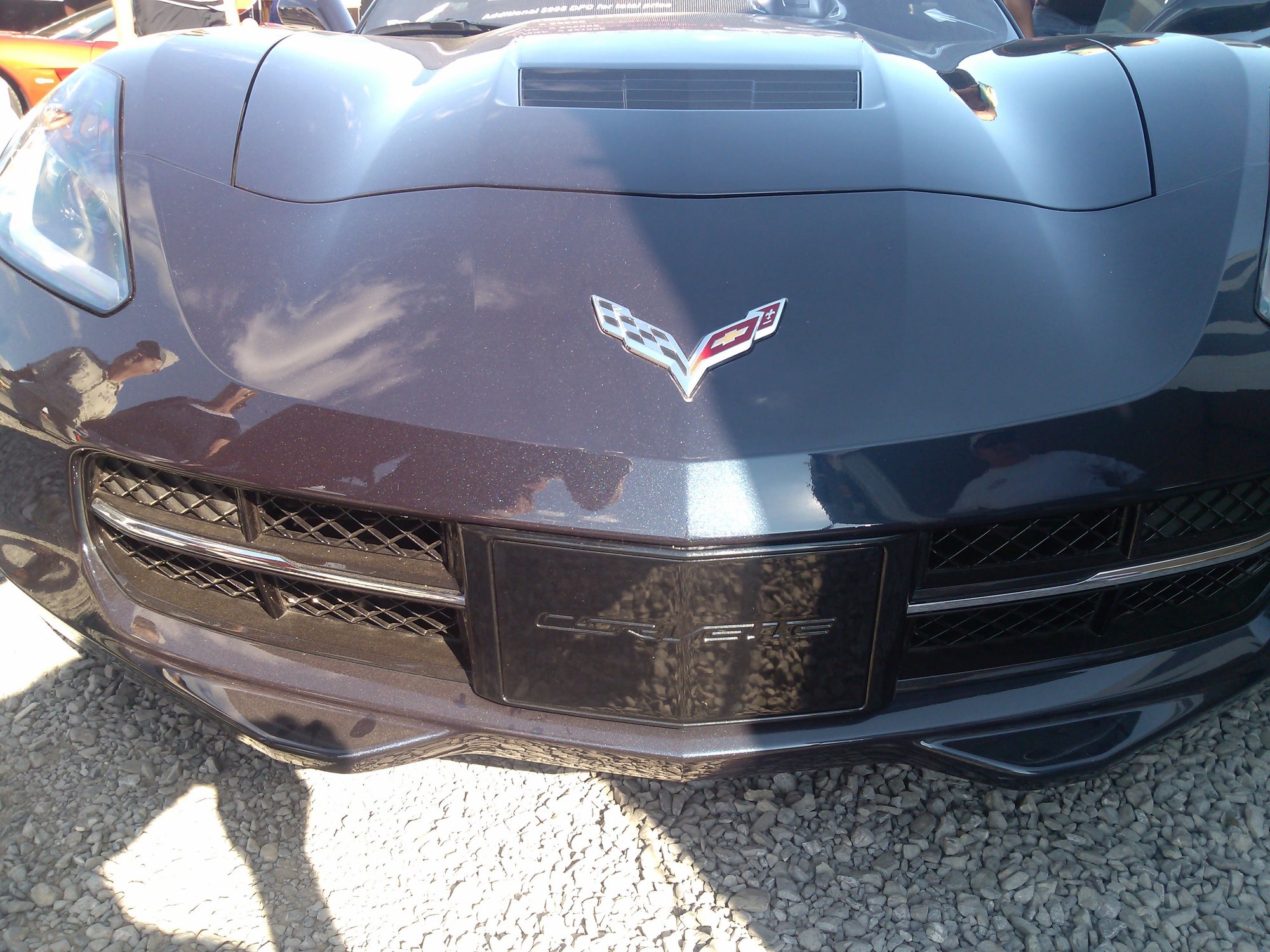

The piece that has the embossed "Corvette" snaps right off and you mount your plate to the remaining part. It's ridiculously simple to do

My C7 is a 2019 model, and GM must have changed the front plate setup because it's not as on your blue Corvette. I've just checked my front plate again, and there's no way to mount the bracket without contact with the bumper paint. The top of the plastic mount must come over the bumper's lip. It doesn't fit if I try to screw it in lower just over the grille. At any rate, I'll ask about it when I bring in the car for my first oil change.

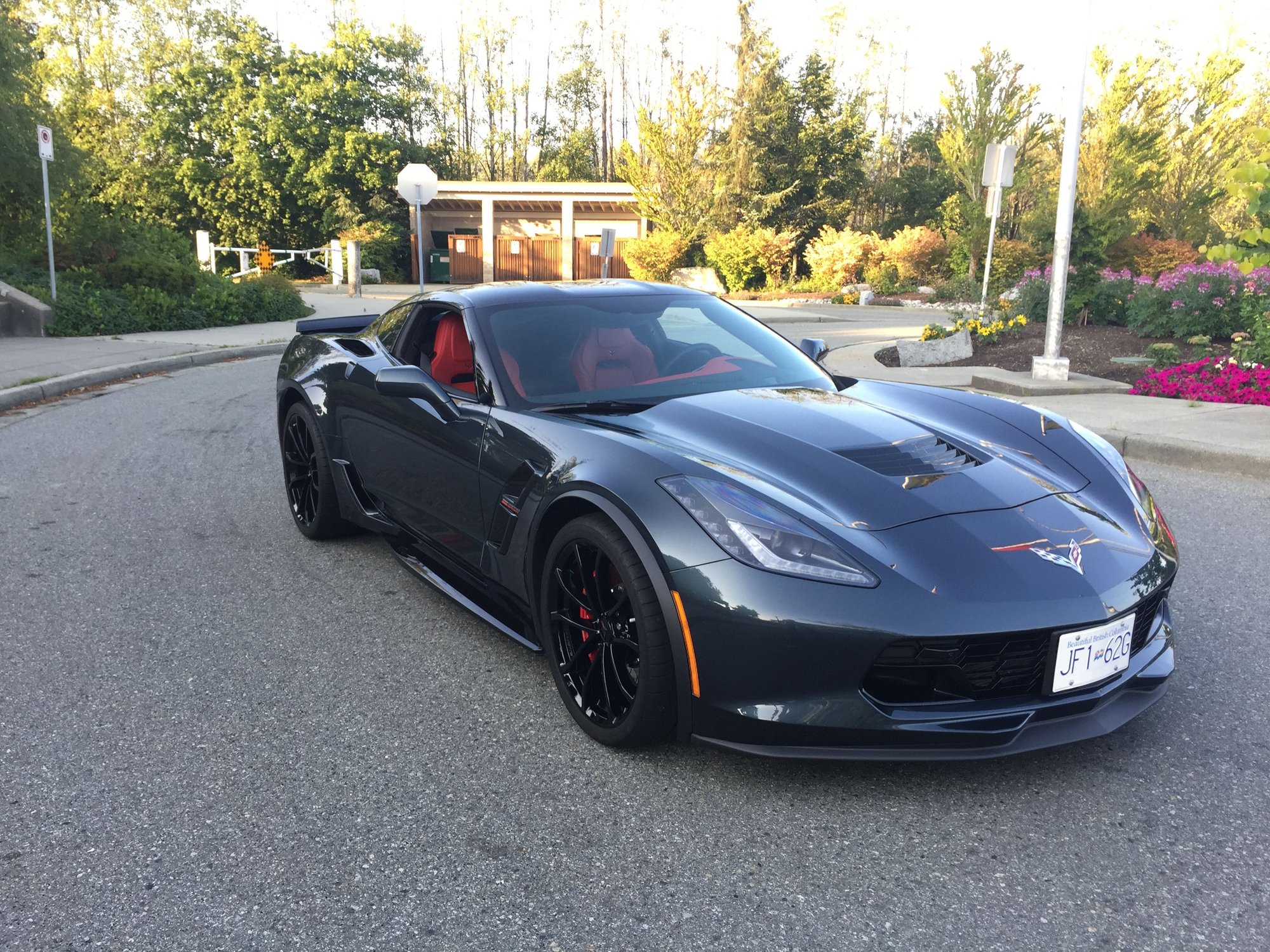

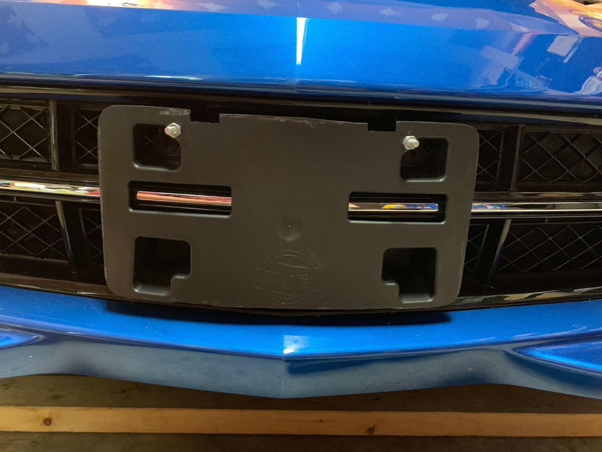

You should have received two separate plate mounting brackets, one that fits entirely within the front grille opening and one that rides a little higher. If you only received one, then the dealer owes you the other.
I got both of these with my 2019:

You’ll find some little indents in the surface of the bracket that line up with the locations of the 4 holes in your plate. Just start driving the screws into those locations, they’ll self tap into the plastic bracket. Don’t drill. I’m assuming you have the 4 self tapping screws.

Ok, figured it out at last! The mount with the Corvette insert does have dimples in the plastic for where the 4 screws go, and the plate is slightly bent when it's installed. Now, the front plate is mounted over the grill without contact with the bumper's paint, which was my concern. I appreciate it, guys! I don't feel too bad, as the guys at the Chevrolet dealership didn't know either, lol.

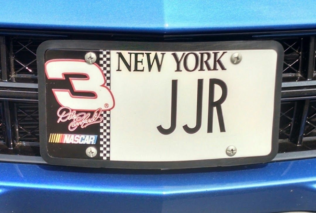

I cut my Aero bracket down and added a Black Rubber frame. I keep in the car and if i am stopped it will snap in the grill.

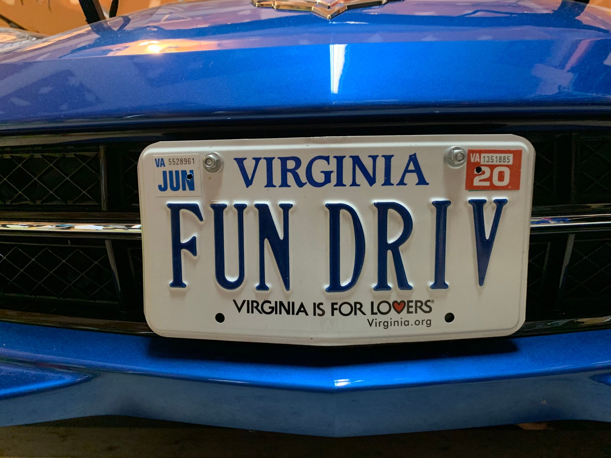

Cut down my aero bracket so it doesn't stick past the license plate.
