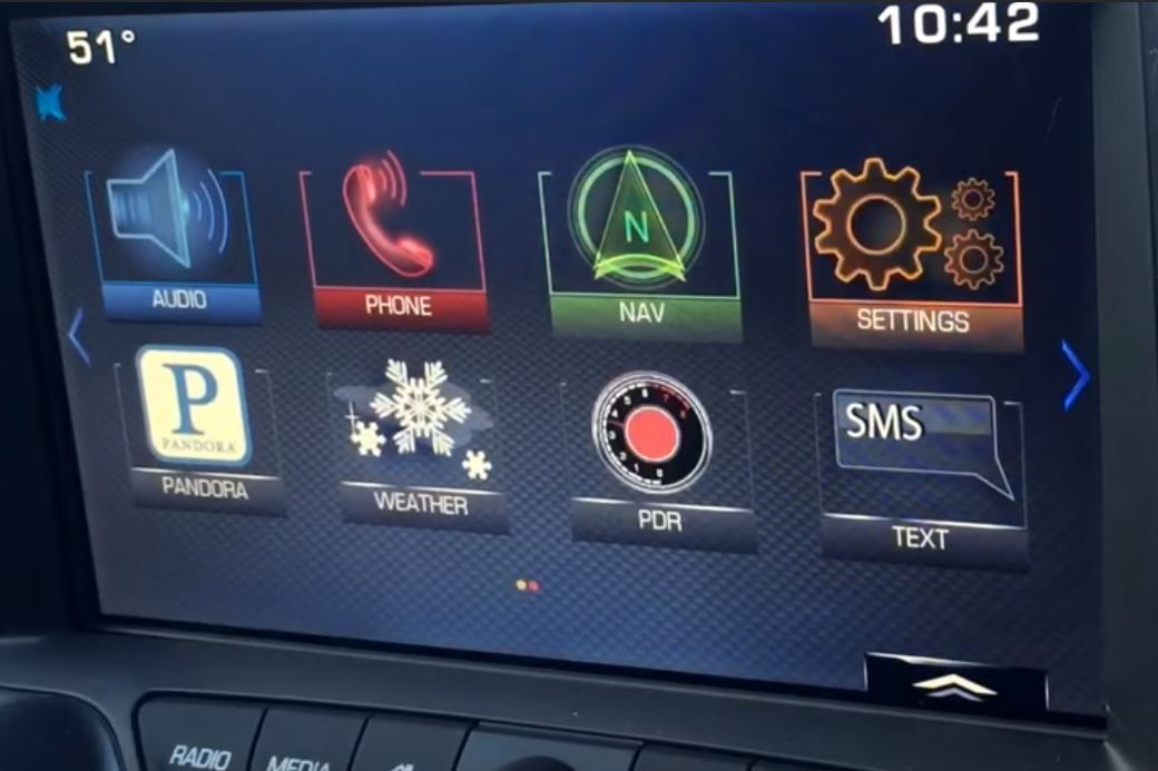

How to disable lock so it does not automatically lock when you leave the car.
Old Oct 16, 2019 | 04:18 PM
KGrant's Avatar
KGrant
Joined: Sep 2016
Posts: 3,076
Likes: 1,204
From: Northville Michigan

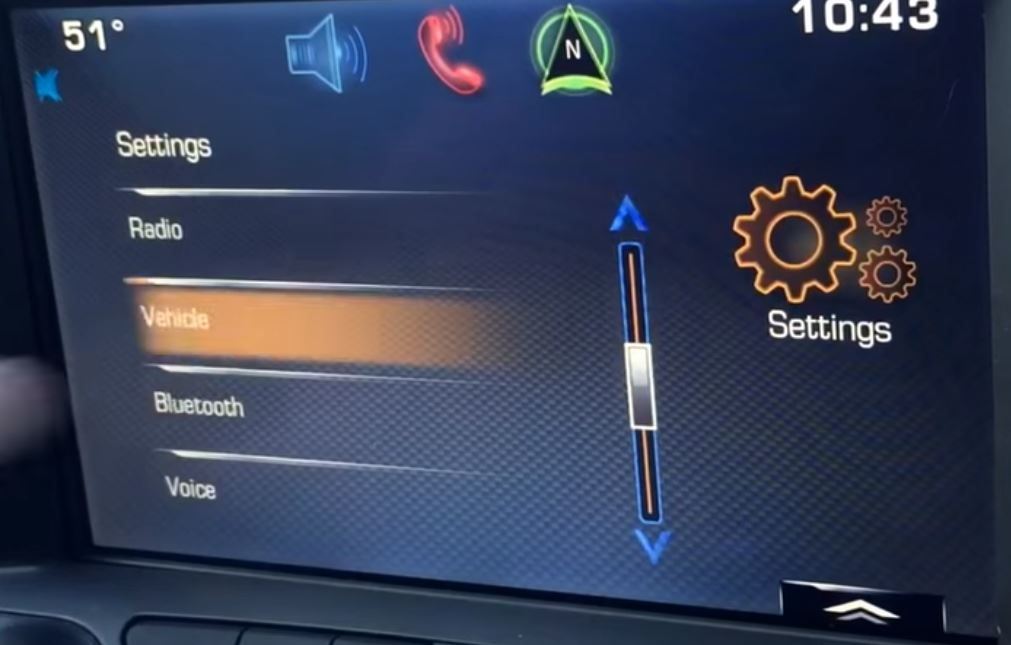

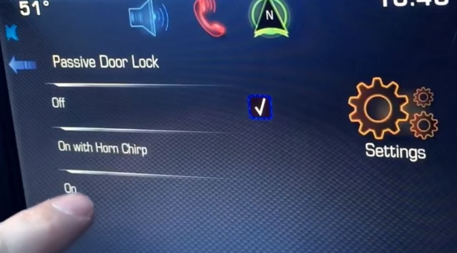

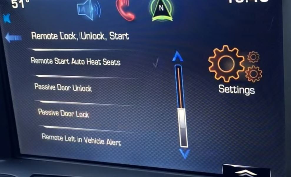

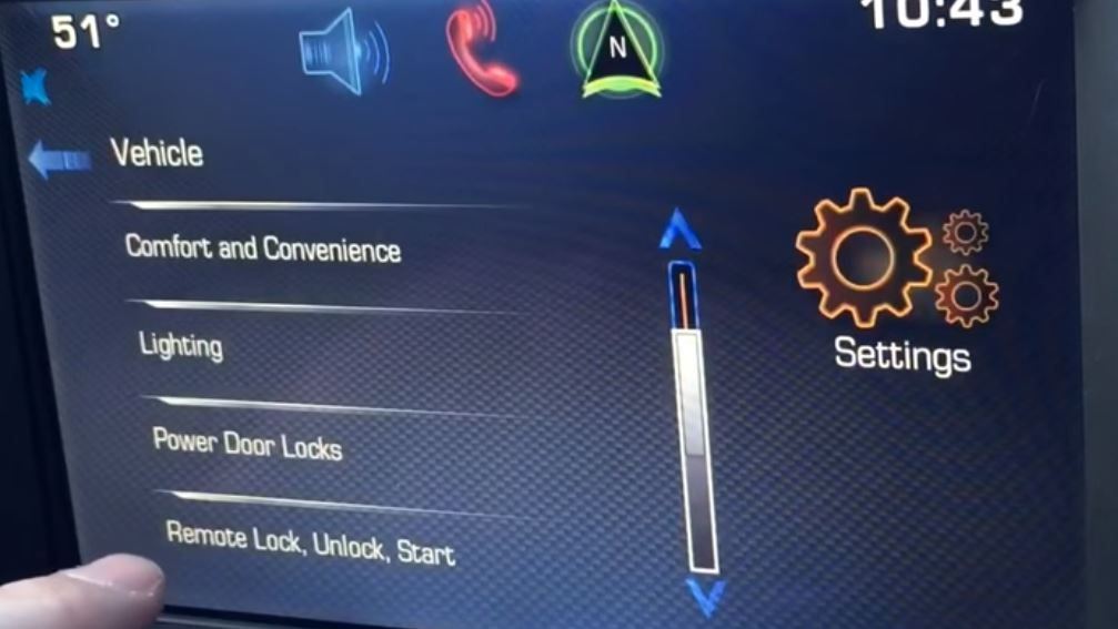

I am away from my car but go to your settings on the infotainment screen and scroll though the list and you should be able to find.......
Old Oct 16, 2019 | 05:51 PM
Makitso's Avatar
Makitso
Joined: May 2015
Posts: 475
Likes: 300
From: Utah
Hold down the unlock button for 5 seconds ( on the driver's door ) you will hear 3 beeps,
the auto lock and alarm will be disabled until next time car is started.
