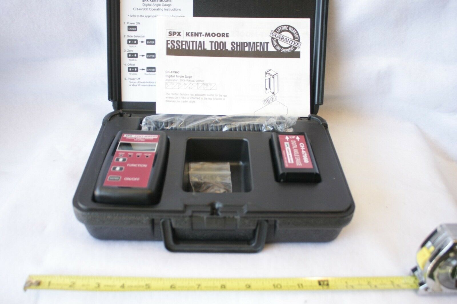

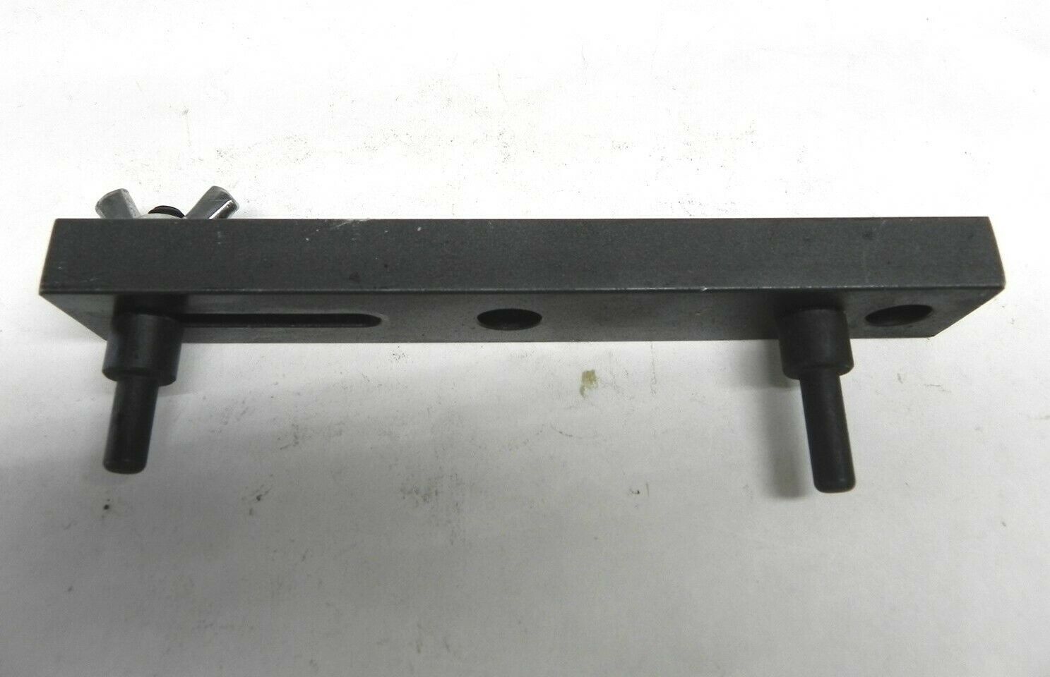

I bought mine a few months ago off ebay, put a search in for this:
CASTER GAUGE ADAPTER KENT-MOORE# CH-47960-10
you also need this:
Kent-Moore CH-47960 Digital Angle/Caster Gauge

You can get by with a cheaper alternative to the second on by buying a digital angle gage used to set table saw blades and such.
