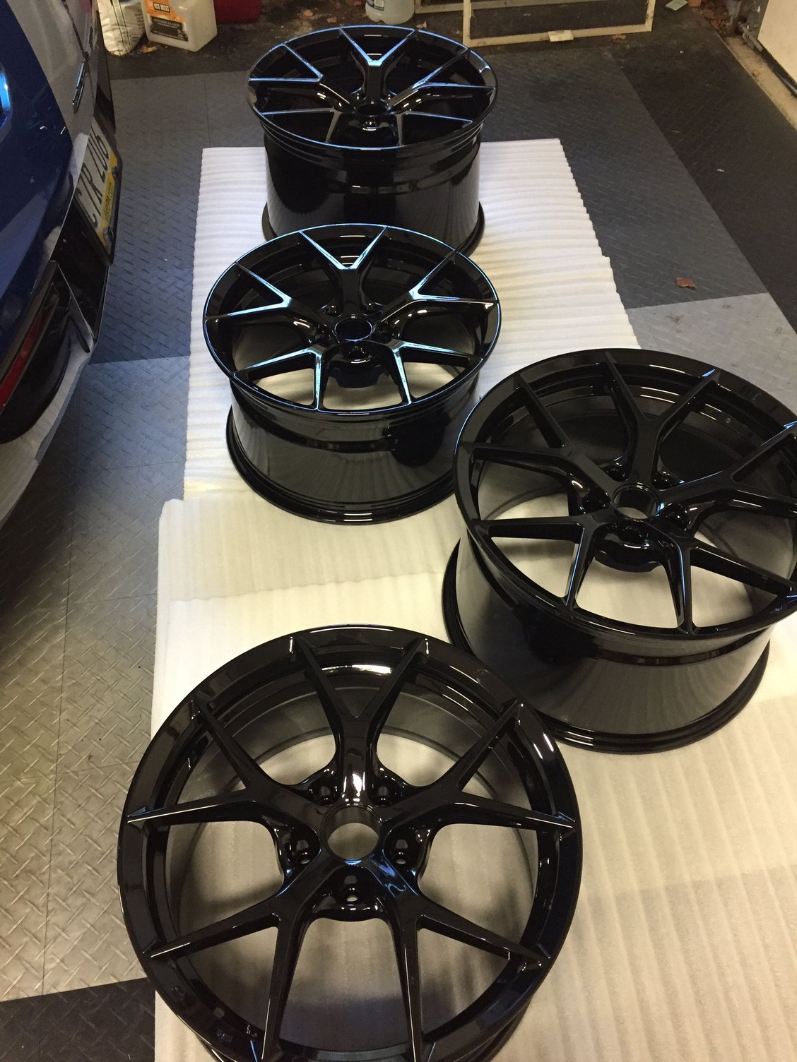

I had these done from Gun Metal to Gloss Black..
Looks great, how much did it cost and time taken ?
Cost was $400
Took 1 week.
