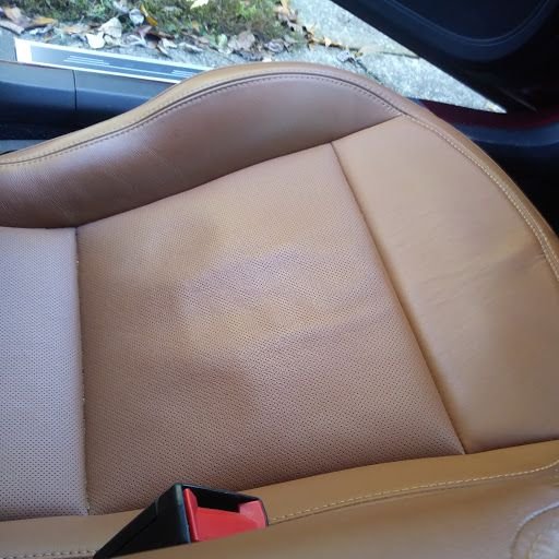

hear is the photo showing the dimples.. I went to the dealer and he said that is where to holes are for the cooling fans and thats normal..???
I asked why they replaced it the first time and they said they were just trying to please the customer...I might call chevy again to update them but i got a feeling thats it. I said if it was a common problem i would understand but no one else i have talked to, even this forum has had an issue ....

I had my cover replaced on my C4 once because repair shop ripped the seat . It never fit tight and looked like your picture. Good luck with your seat problem.

someone suggested a heat gun to tighten up the seat??
I just called chevy again and told them what my dealer said and they are looking into it...Sent them some pictures...will seelll

You are not alone.
Cooling fan cutouts are the issue.
Affects 2LT and 3LT cars only. No cooling fans in 1LT seats.

I went to another dealer today that had a used 2017 and 2019 and THEY BOTH had this issue...My bad....Live and learn... The 2019 only had 1000 miles on it....The sales person said he had never noticed it...I stand corrected....doesn't mean it right but there it is..
Thanks to all...Sanford
Thanks for the above links...made me feel better...will try the wet cloth first and maybe try a heat gun, but am a little nervous about doing that....
