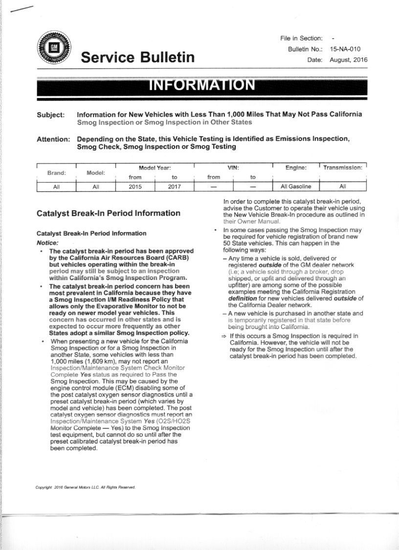

Drive cycle won't fix it. You need to get more miles on the car. The ECM prevents the post catalyst oxygen sensors from working for up to the first 1000 miles. I went through this when I purchased my car out of state and had to get it emissions tested.
