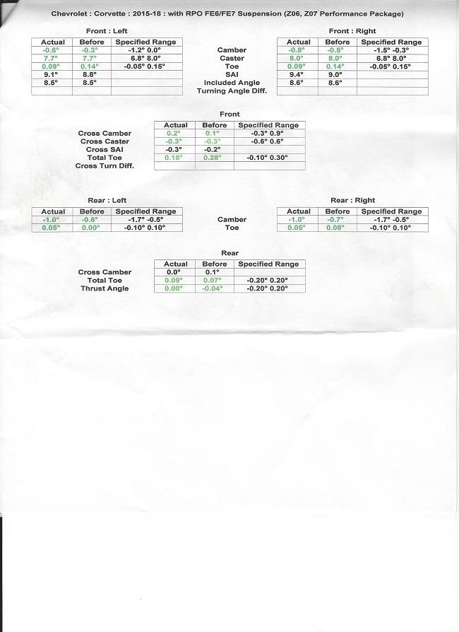

This is my 19 GSName:  photo615.jpg

Originally Posted by TNSQUIRE
This is my 19 GSAttachment 48306281
Im about to get new tires and want good tread wear but this confuses me. Wish I knew what to tell them.
I have a 19 GS as well. Is this how it came fromnrhe factory or after an alignment?
After alignment. Street specs. This got me 30k out of my tires on my first C7
I used this on my first C7 and got 30k miles out of my tires

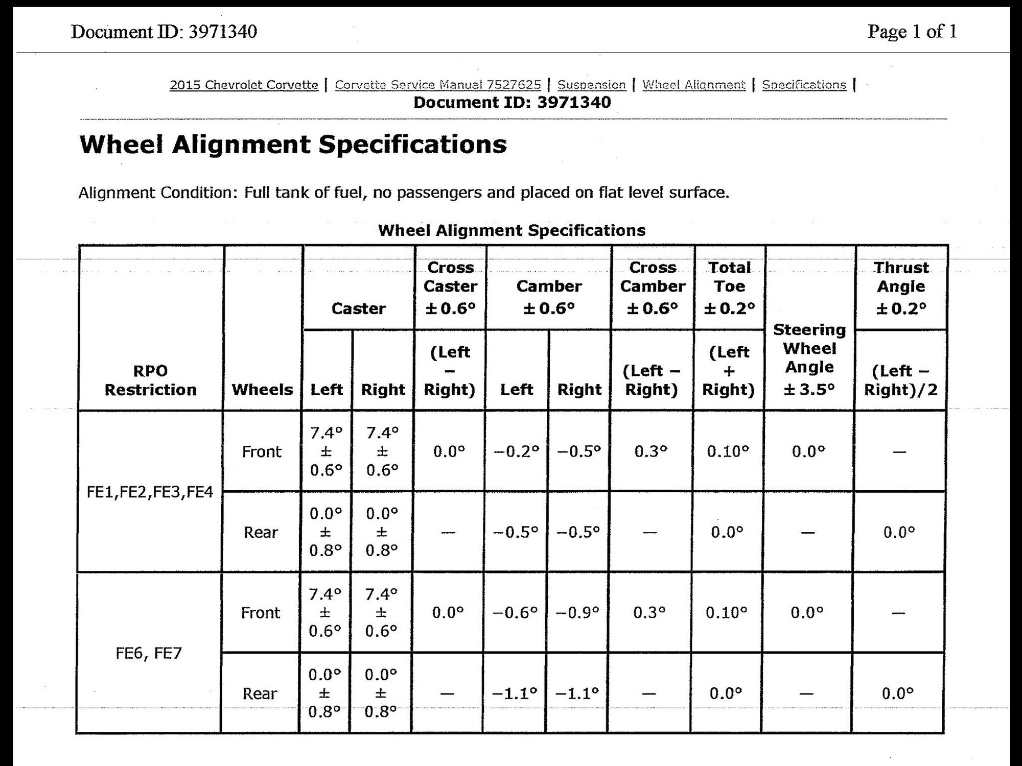

Here are the specs shown in the factory service manual:
Bill
