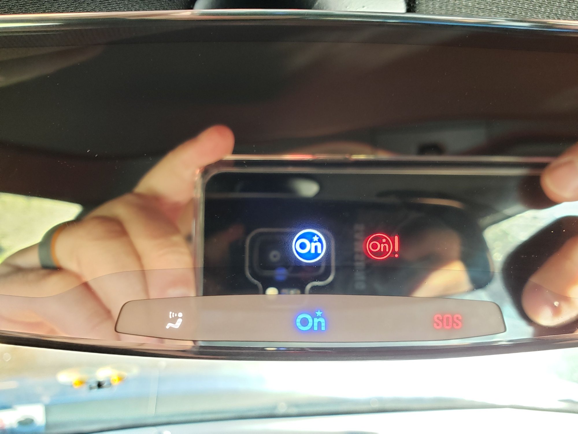

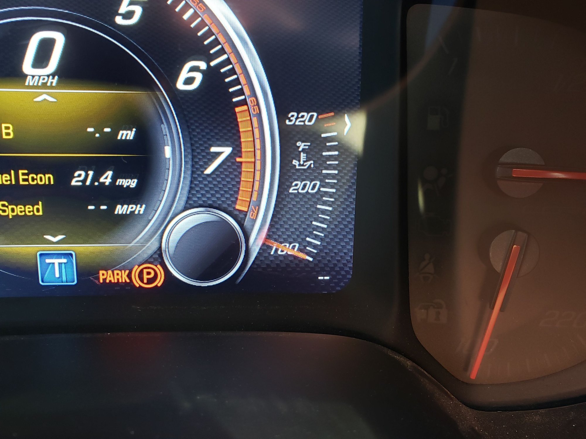

Thanks for the responses. Ron, I do not have a red X, just two dashes on the dashboard display (see pic below) and indicated direction does not change. It's the factory windshield and I also tried to call onstar today via the mirror. It will not complete the call and gave me the error exclamation on the mirror (see pic). I have narrowed it down to the cell/gps antenna or the VCIM (Onstar module behind the glovebox). I figured the antenna probably has less of a chance of going bad than the VCIM (many have reported issues with the circuitry). Since my bluetooth is still working and the GPS displays dashes instead of a red X, I am going to attempt to replace the radio board of the VCIM without having to replace the whole module and have it reprogrammed. I'll report back if that doesn't work, as the next possibility is the gps/cell antenna itself.
