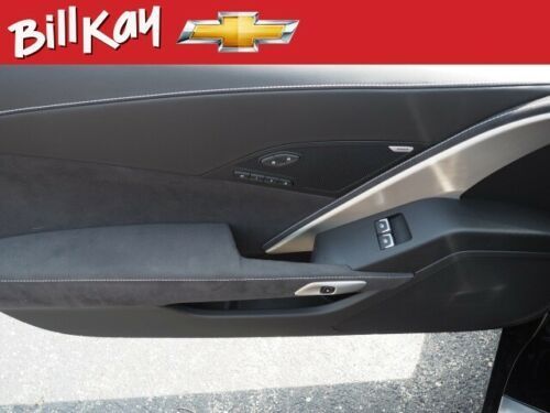

I think this is it, but try to verify it before you spend any money. RPO ZLG was the Black Suede Design package.
84094599
TRIM, FRONT SIDE DOOR(INCLUDES 4-7,10,14-18,26)(BLACK)
Location: Driver Side
Fitting Vehicle Options: YY,YZ(IL8,ZLG,19I)
84094575
TRIM, FRONT SIDE DOOR(INCLUDES 2,3,6,7,9,11-15,17,18,19,23)(BLACK)
Location: Passenger Side
Replaced by: 84287569

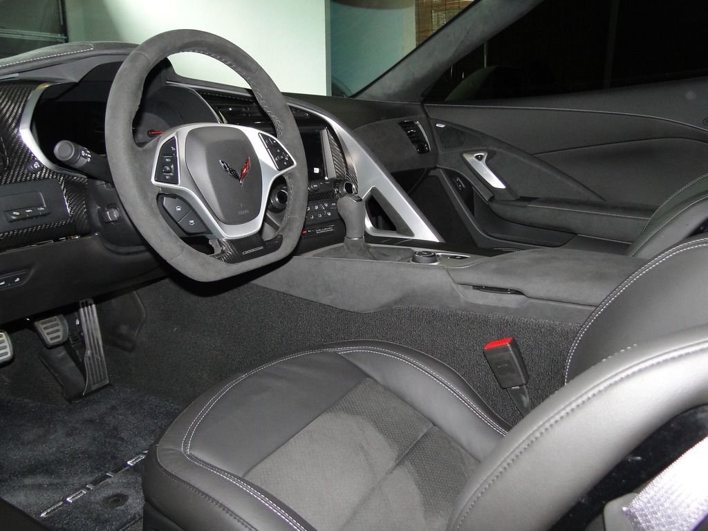

It depends on what you want.
Do you want panels from the Black Suede Design Package (2016-17 RPO ZLG)?
Or Ebony Door panels with suede (2018-19 RPO 198)?
The Black Suede Design Package does not have suede above the arm rests where newer panels do as shown above.
Like stated above, find a VIN from a car that has what you want to order panels to get exactly what you want.
