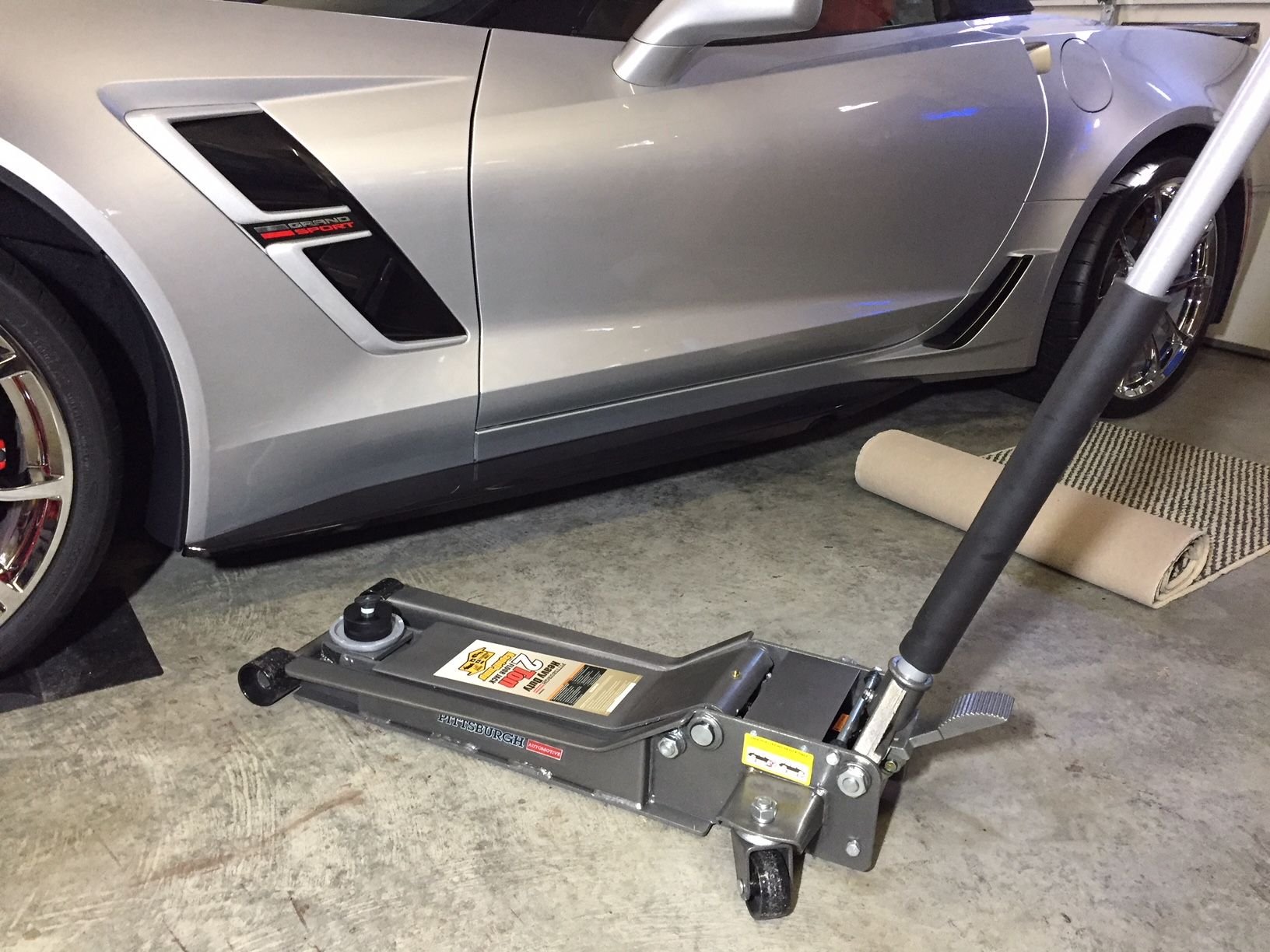

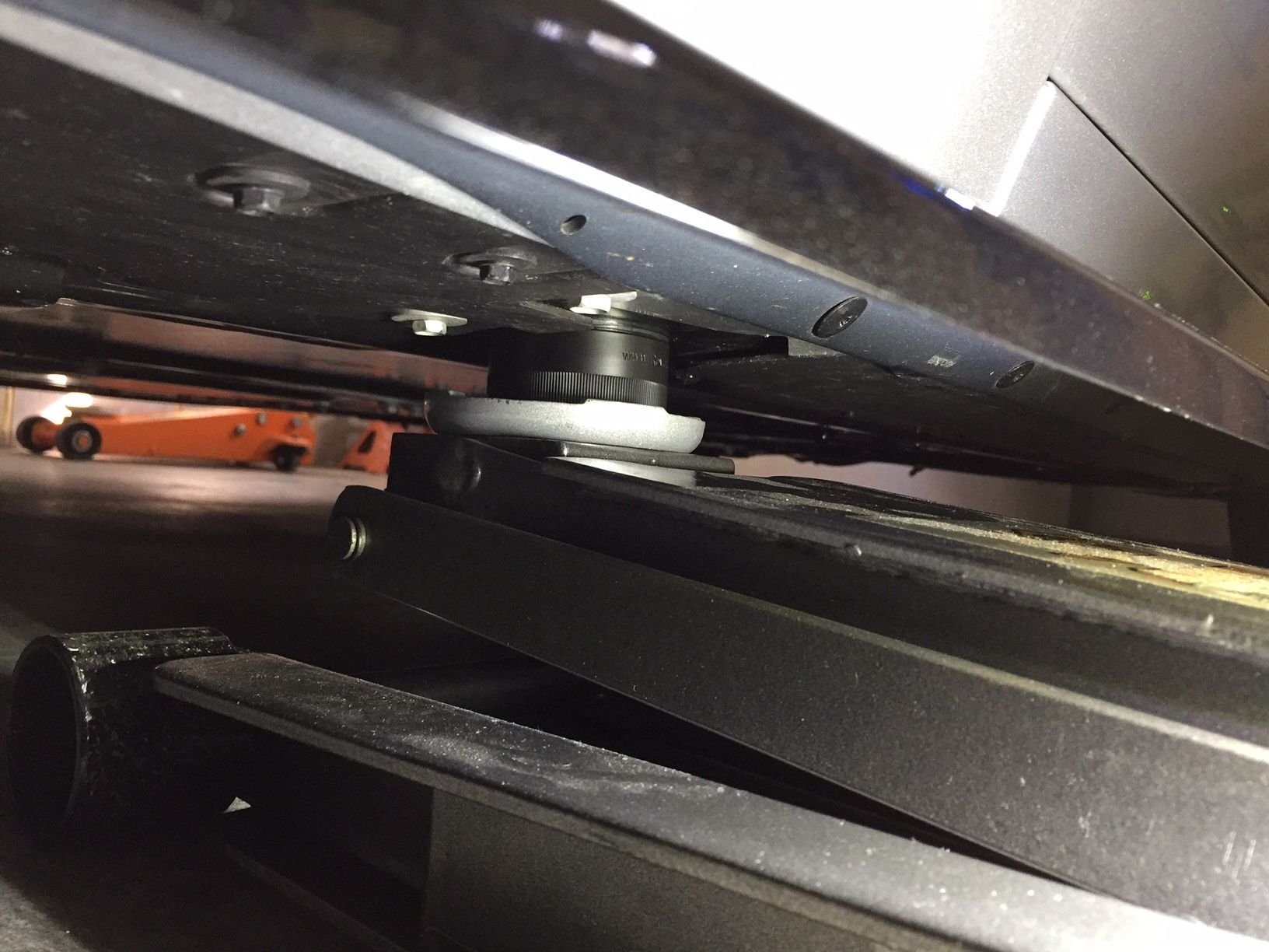

It's all how it's used! All hydraulic jacks MUST move in as they lift. The amount depends on the length of the lift arm (see pic) and the amount of lift. Just check the jack saddle to jack puck position after each pump.
Note, I bought a long reach jack with a 21 inch long lift arm that only had to move in 1.2 inches compared to the 2.6 inches for the same height lift on my small 10 inch lift arm jack. BUT it weighs 95 lbs and won't rolling in at all. Decided to increase the jack saddle rim height by welding on a ~3/8 inch piece of steel. ! That captures the aluminum jack pad and the jack is pulled in! Just be careful when pumping and you will be fine. Also be sure the jack is perpendicular to the car side AND you rotate the caster wheels (if it has those) so they are ready to roll into the car.

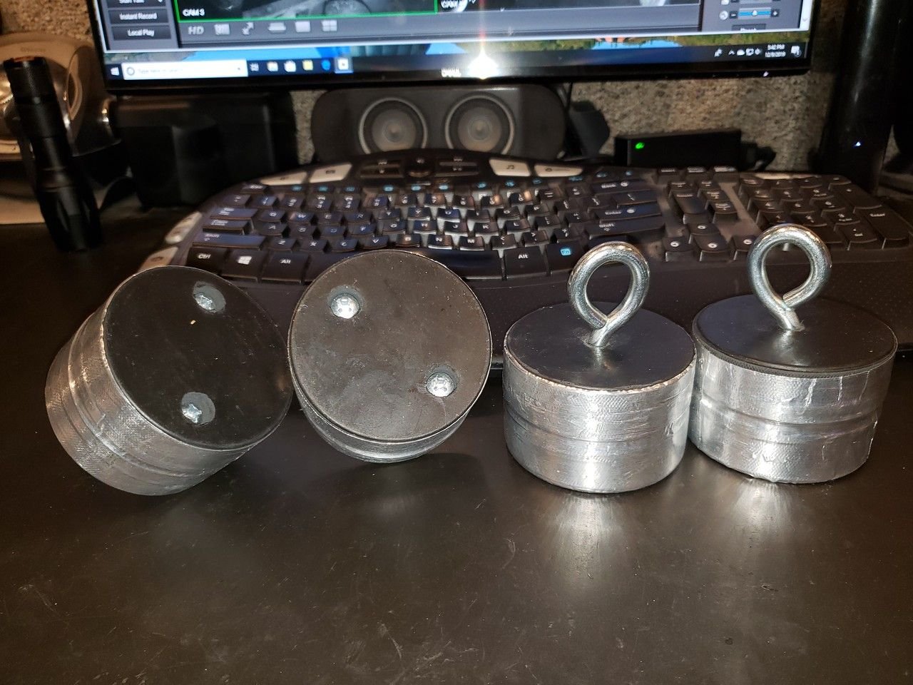

double height pucks... cost to make 16 dollars total

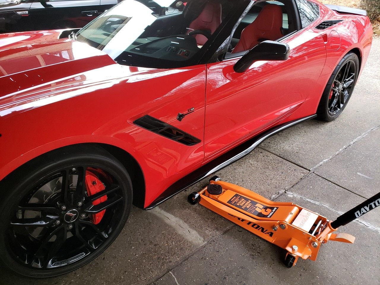

Long reach low profile jack
Making sure the jack is able to move forward as the lifting arm raises is important.

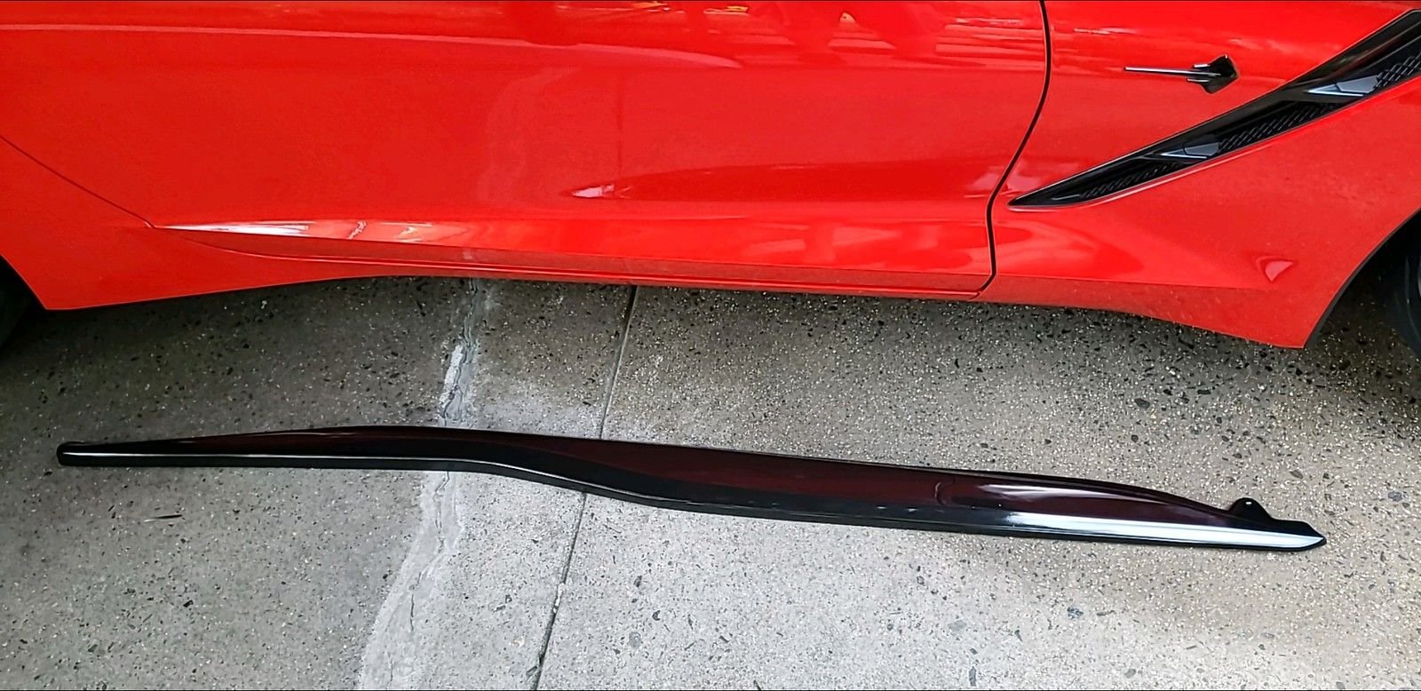

If you read my posts.. I said they are necessary with side skirts that I have which are lower by an inch than the rockers I said anyone using a single puck and a short low profile jack will have their lifting arm hit the side skirts.. I have a regular low profile jack and about a dozen single height jacking pucks.. they have worked for 20 years on my C5 and C7.. it wasn't until I added the side skirts did I find the jack and the single height pucks to be in adequate.. to say its over kill is suspect to what I call the downer syndrome not knowing what they are talking about... My C7 is lowered and double height pucks drop below the side skirts and my long reach low profile jack can now reach the pucks that are inhibited by their width.
These side skirts lower the ground clearance and stick out from the puck location.. reaching them without hitting the shirts requires a long reach low profile jack and double height pucks.

along with this one
Originally Posted by Evil-Twin View Post
Sure.. if you need lifting pucks, this is a very easy self esteem building project... Ive made several sets of the standard height lifting pucks for myself and several friends.. I have a set that is 20 years old ( single height ) . I ordered 8 hockey pucks from amazon and a third party vendor @ 1.49 each and free shipping with no minimum. ( received them today. Four 3/8 eye bolt screws 1 inch long , Eight # 10 X 1 1/2 in. pan head Philips screws. Home Depot I had some aluminum tape to use as illumination to make sure I could see the pucks under the car where it is in the shadow and hard to see for me. Make sure you get official NHL Ice hockey pucks... 6 0z. 1 inch by 3 inches. There are several types of hockey pucks. Street, Roller, Practice etc.. you want the best quality .ice hockey pucks.
drilled a hole in the center of four pucks that was the size of the minor pitch diameter of the eye screw. smaller than the dimeter of the outside thread diameter. Screwed the eye bolts in. Lined up the second puck beneath the first then taped the two together, so they would not move. I used electrical tape around the circumference then place them in a vice. I drilled two pilot holes @ 180 * degrees to affix the bottom puck to the top from the bottom … I then drilled a head clearance hole using the pilot hole as a guide. 3/8 in deep . hand started the screws and drove them with a torque driver..
If this is not clear.. tell me … if you have questions, ask them/// Ive seen double Hight pucks as cheap as 50 dollars and as much as 100 dollars.. these 16 dollar pucks Ive made will last more than 20 years.
