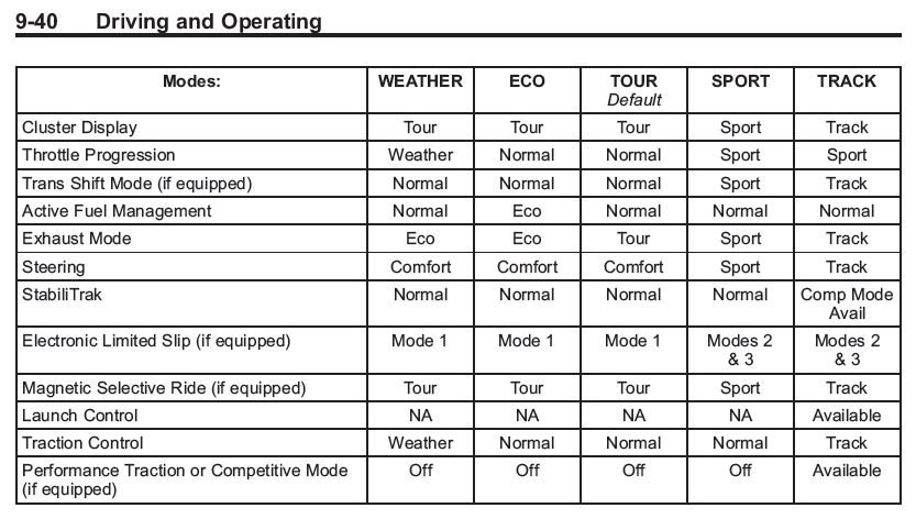

I also have a base Stingray and the only thing the drive selector does that I can tell is change the exhaust sound. If it does anything else, I cannot tell or feel it.

Make sure Link to Drive Mode is turned on. Below is what changes... just note depending on options not much may happen as indicated by (if equipped). Also some settings like steering and exhaust have over rides so it possible those are locked into a different mode. Check they are set to Link to Drive Mode as well.

If link to drive mode is on via settings the steering really changes between comfort and track.
