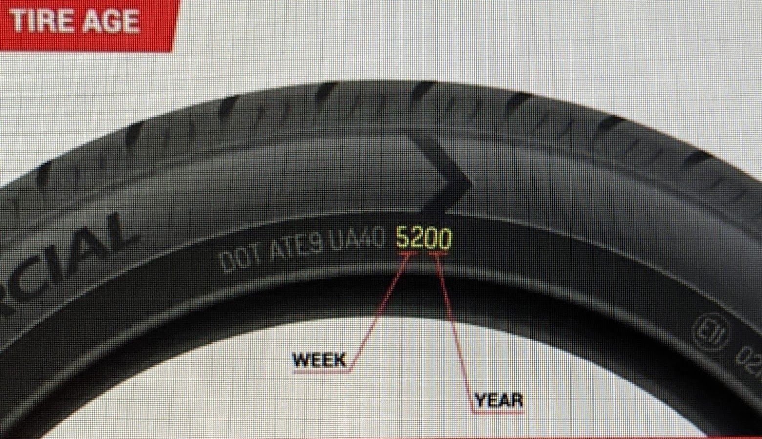

Please replace those the next time you remove it from the garage. Those tires are about 15 years beyond the expiration date. Enjoy your garage sculpture.
Time is just as important as miles. If you drive, that is.

Very good advice
Tires will dry rot. When they fail it is at a speed and manner you may have hard time to recover from?
Many tire shops will not fix or remount tires over 6 years old. It is not a function of mileage or tread wear.

Check the date code.
