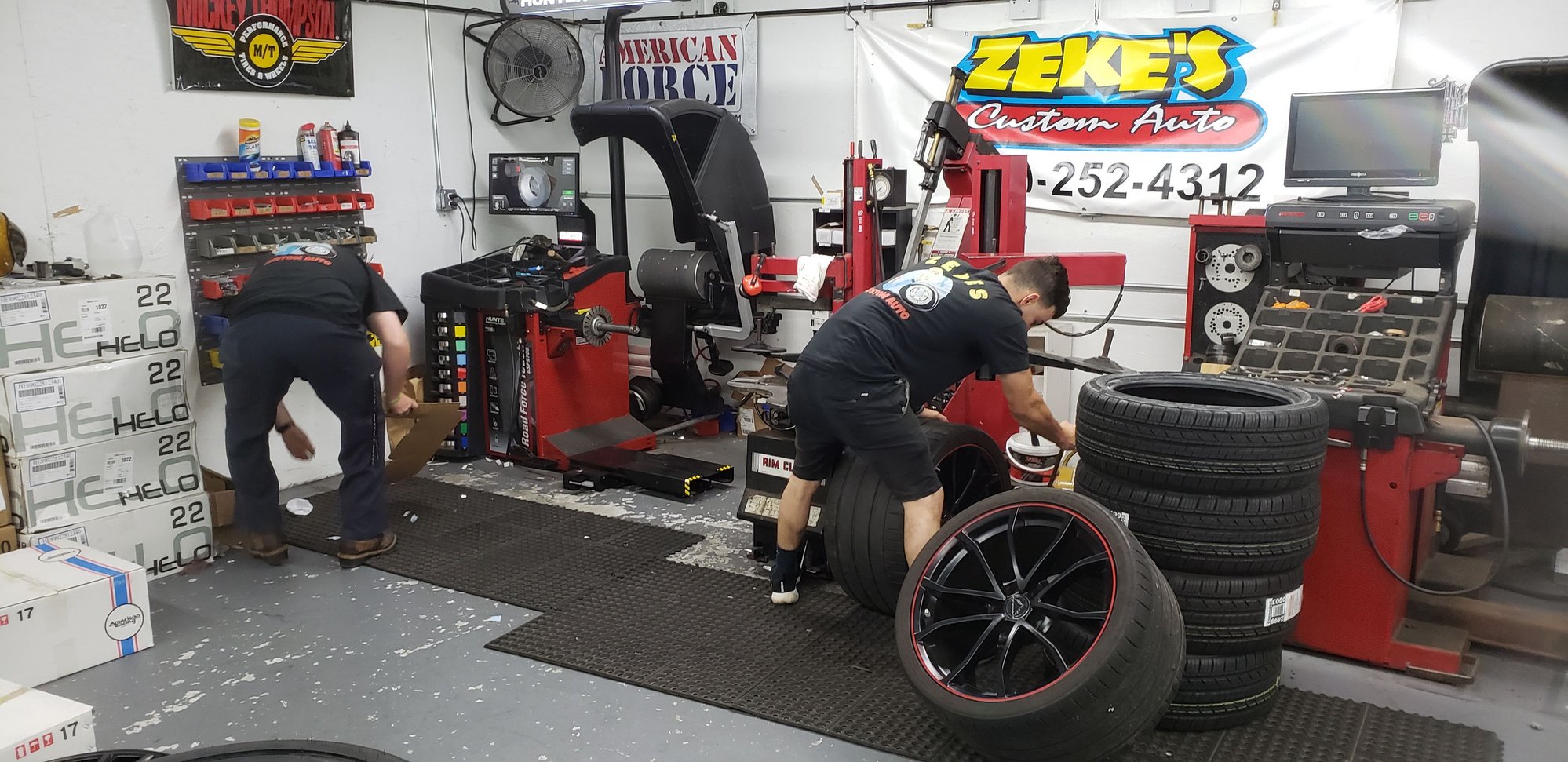

What makes the Corvette different than any other car? Just curious because I'm getting a second set of wheels and some all seasons mounted.

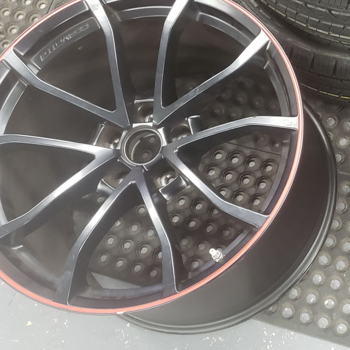

Not sure what others have But these Fat Cast not forged rims are bending and cracking with minimal use.They are so fragile.Just look how thin the flanges are.
A touchless tire machine.Meaning slight pressure on the flanges.
Breaking the bead is dun on the floor squeezed with 2 arms contacting tire only
Lighted up by GM To save weight and cheapen out being Cast manufactured.This is a 20 inch rear(Bent of coarse)

Thanks for the explanation! I was going to have DiscountTire mount my tires, I'll see what they use.
