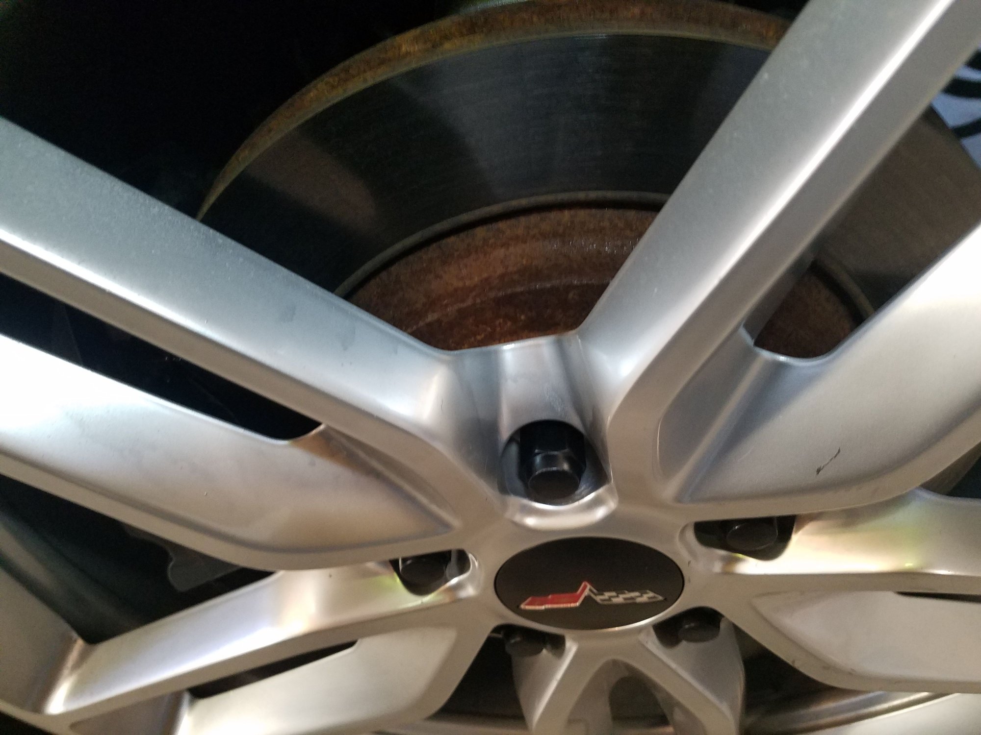

I own a 2015 Z-51 Vert. and want to make improvements to the present rusty conditions at my brake rotors this winter while the car is idle. The fronts look close to new, but the rears are rusting. Any advice on how to make them look like new again would be appreciated....The calipers are all gloss black and still look perfect on all fours...just the rear rotors look bad. I intend also on refinishing my wheels at the same time while dismounting the super sports and having all seasons installed...any recommendations on the type of paint that should be used would also be helpful. Thanks in advance for any help offered...

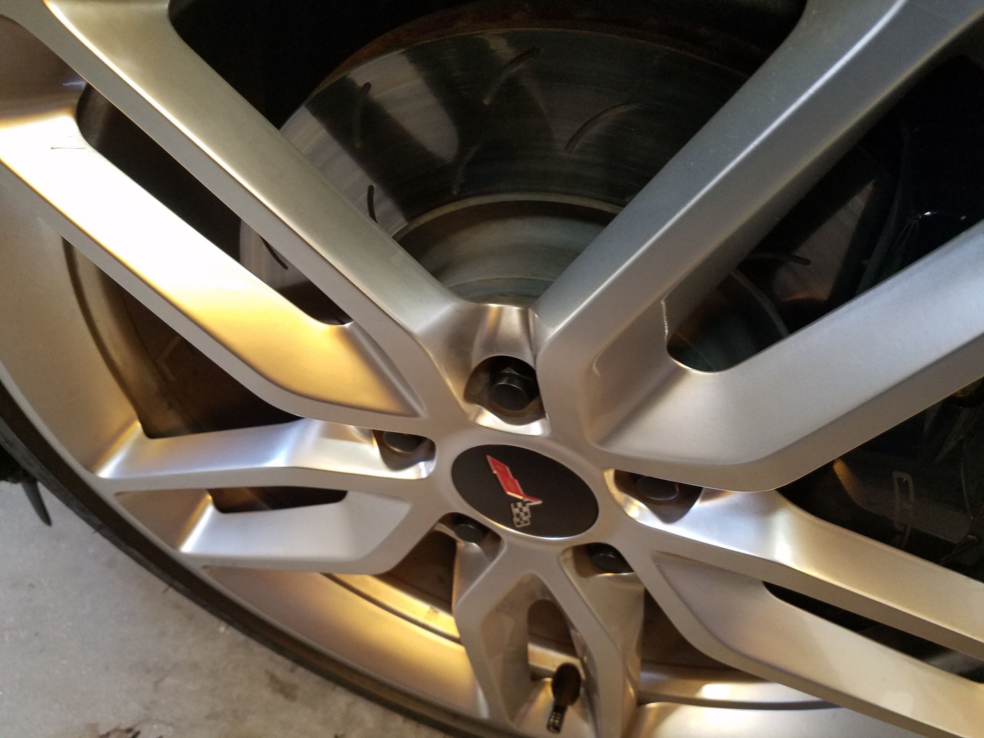

Yes, I was referring to the rotor hats...and not the surface where the pads make contact...sorry for not better describing. I know that I need high heat paint, but cannot find the color that looks like oem...which is a light grey in flat sheen. Here is a pic of the front drivers side and the rear drivers side...I found a flat grey extreme heat primer yesterday at a local auto parts store, but the primer made no claim of resisting further rust and had to be top coated as well. That's when I stopped looking and sought advice here before resuming the project.
Also seeking advice on the use of any sort of special paint when repainting my oem wheels...
front
rear

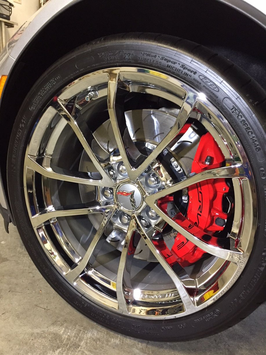

Hmm, have not tried on the brake hats BUT the ~$10 solution I have used on my 2014 Z51 mufflers AND my Grand Sport should work fine. It's NOT paint. It's a watery solution that turns iron oxide into a blueish-black ferric tannate. My experience with exhausts is it's better than paint as it doesn't peal! My 2014 mufflers were 3 1/2 year old when I sold it and looked like when I did it. My Grand Sport now 2 years old. It is not like paint in that it does nothing to none iron oxide! Just put on a few light coats and wait 30 minutes between.
This is a PDF of my use on C7s: http://netwelding.com/Muffler_Rust.pdf
Here is a before and after view of the many pics in the PDF. If you have not bent down and looked t your mufflers- try it!
