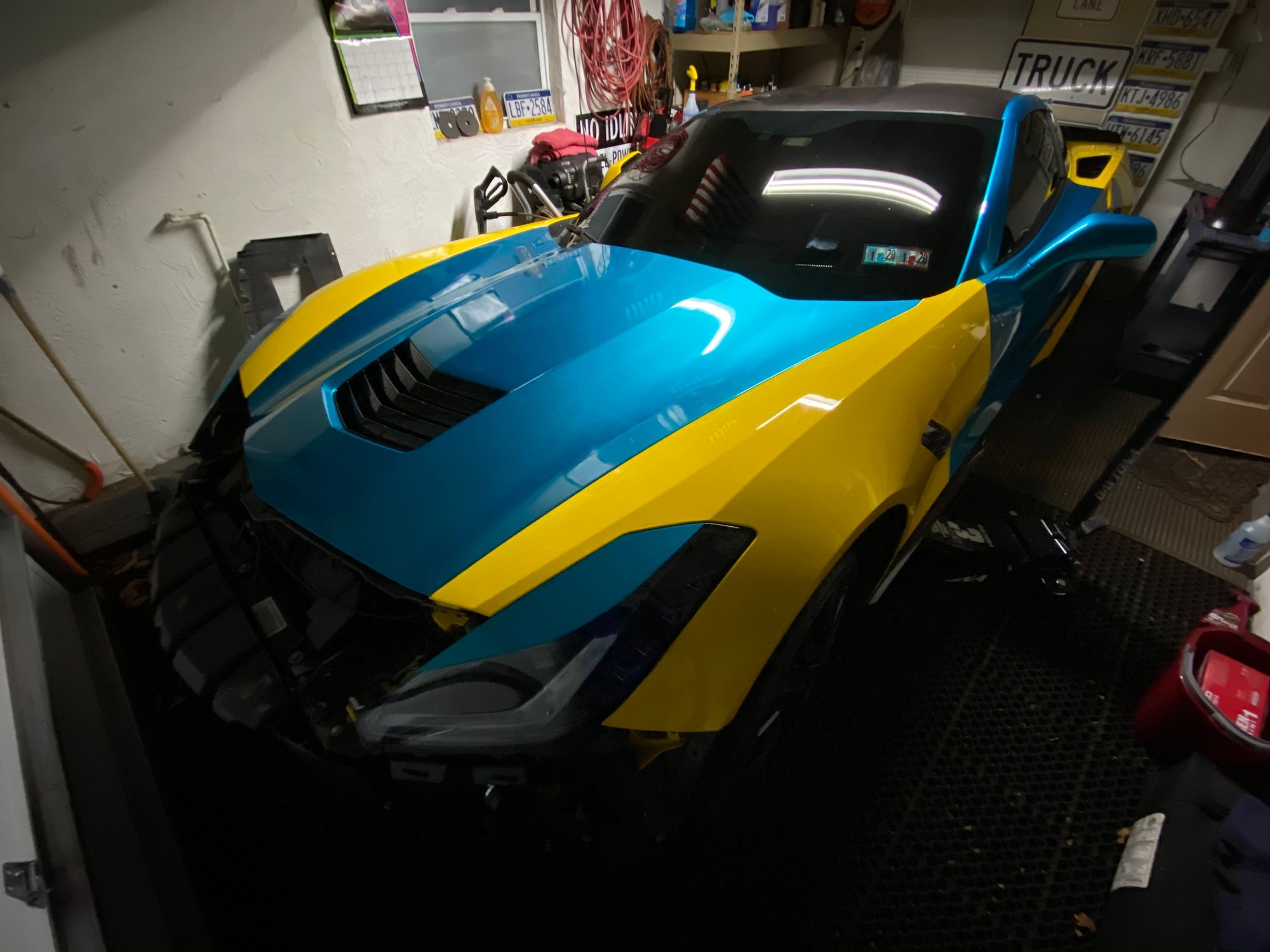

I f*cked myself with this one... so my battery is dead and I’m backed up about two inches to a wall. Are there any other ways to get in the car other than through above the plate? I also left my primary key in the car...

Jack up the car and put jumper cables on the hot lead to the alternator and a ground. That'll get you juice to get into the car and might even get it started.

So I searched and searched and found my second key, I was about to hook the car to my truck and drag it a foot out but decided to attempt to reach and put the key in the slot above the plate. I had to climb on and over the car, barely squeeze my arm between the wall almost dropping the key but I finally managed to get it open. Sounds like a mistake I won’t make again! Gonna Start leaving the battery tender plugged in.
