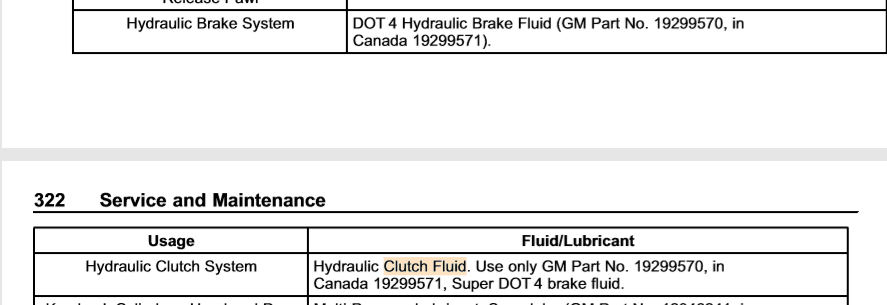

From the 2019 Owners Manual: DOT 4 for Brake and Clutch.

The C7 2017 Manual says to use DOT3 and change every 5 years, 2019 says to use DOT4 and change every 3 years.
