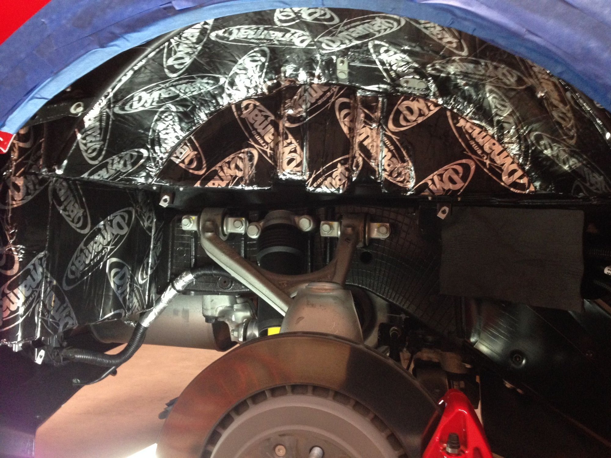

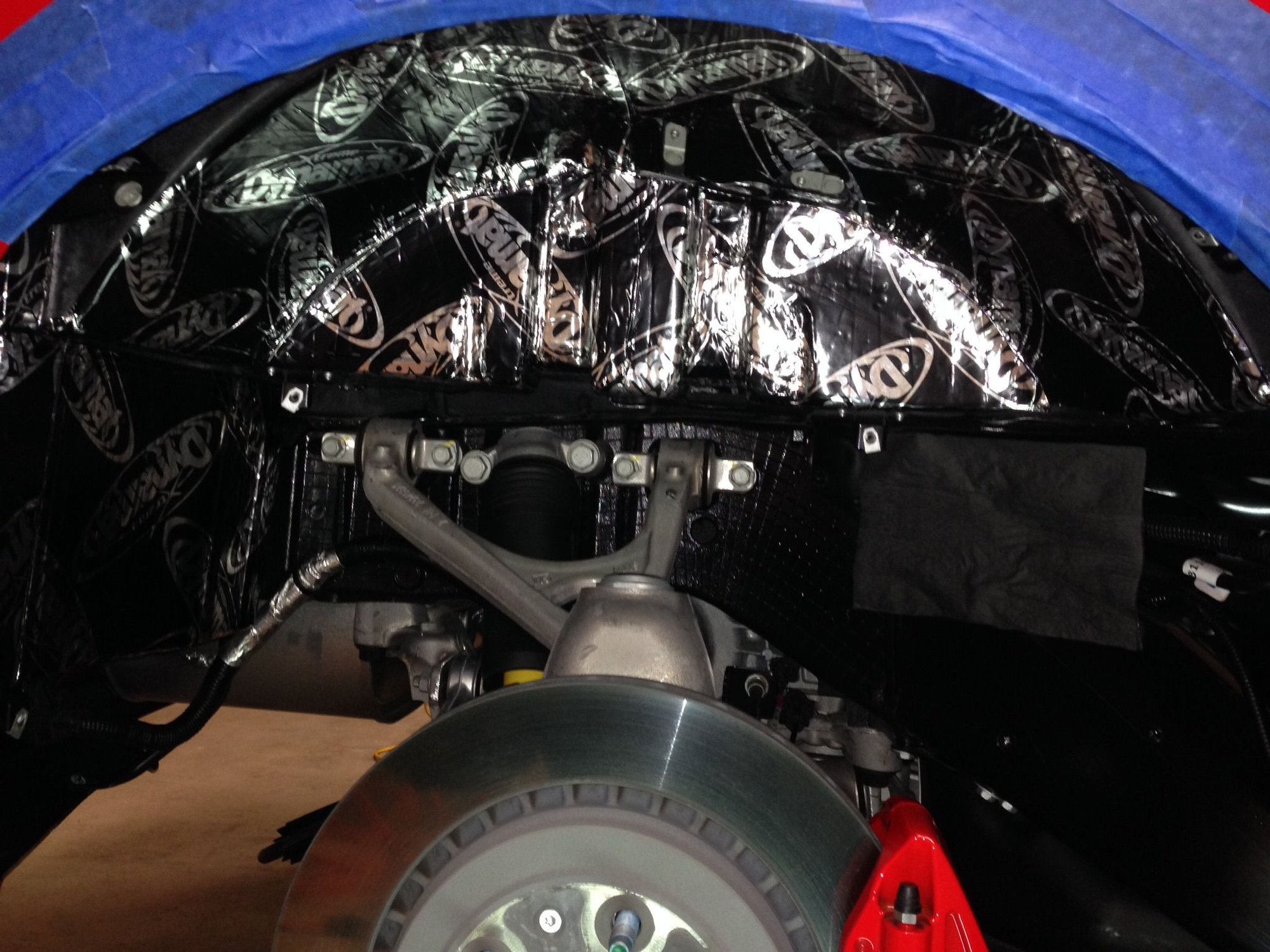

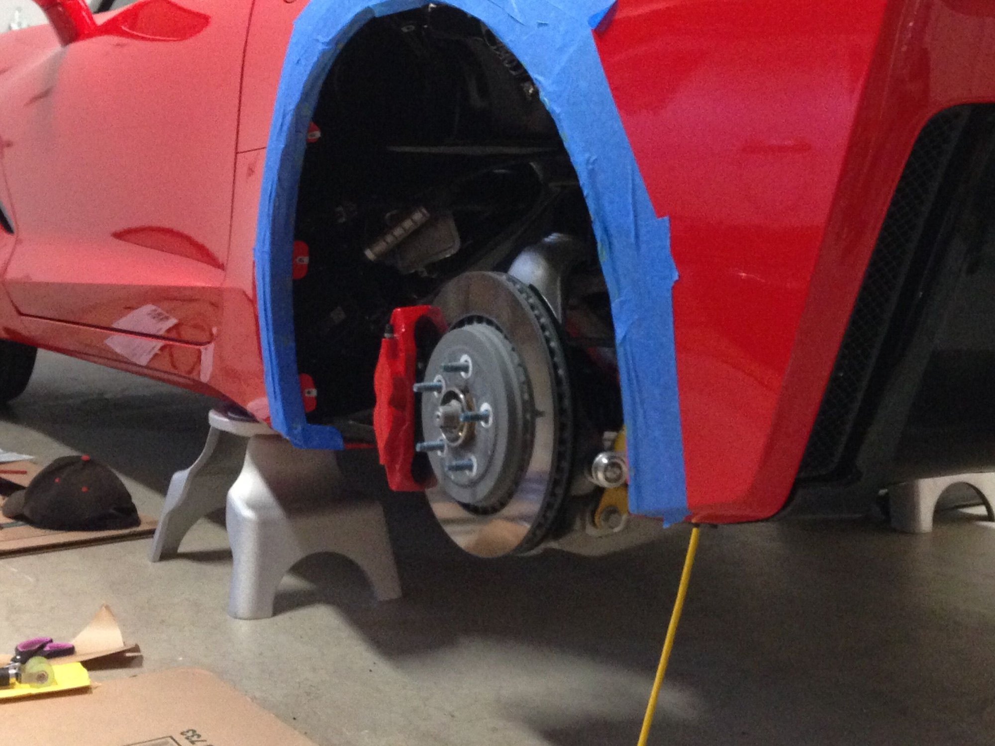

I added the BlockIt mats behind the seats then took two additional steps that greatly reduced the road noise even more. I lifted the carpet behind the seats and laid down Dynamat and then removed the rear wheel wells and laid down a double layer of Dynamat.
