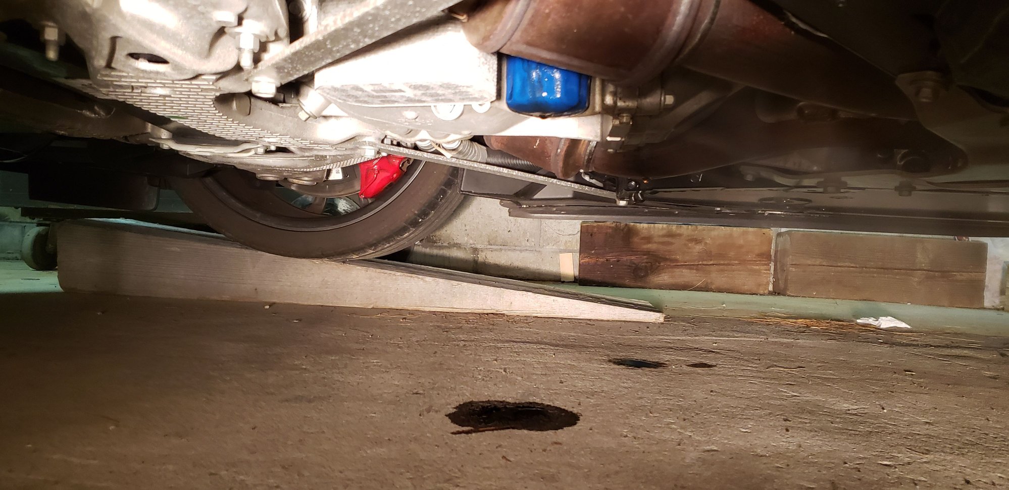

Smart getting it checked early.My delay cost me 2 rear tires to Dam early.I would ask if you could look at your car when they are done with your oil change while on the lift.
Play it like your so interested in what it looks like underneath.
Ask a bunch of questions about anything.Then ask,ahh is this filter tight? Show me.
Did you drain BOTH Drain plugs? Are they tight? Show me.
My filter almost fell off after maybe 200 miles.Doesn't hurt to ask..
Good thing I saw the puddle.
Copeland Chevrolet Brocton Ma.Don't go their

Yes Copeland sucks. Oil every where on my car and over filled. Had to donut myself
