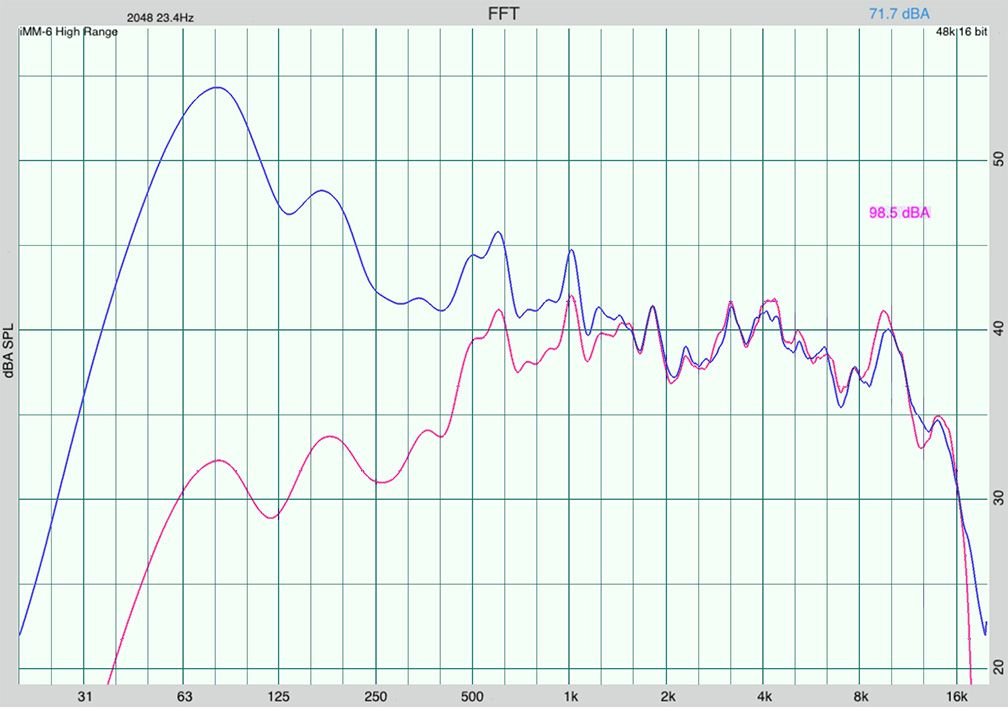

Its not very good. I've detailed why in many threads and will do so again for the record.
It suffers from all the normal problems you find in car audio (limited dynamic range, poor frequency response, bad sound stage, etc)... just made worse by the Bose processing. The Bose system applies an automatic EQ (actually just a simple bass shelf) that actively removes low frequency information. See below...
This chart was created with a calibrated microphone, pink noise (equal energy) and pro-level FFT analyzer software. The blue line is low volume, the pink line is high volume. I aligned the high frequency response because as you can see it doesn't change with volume. However bass drops as volume increases - plain and simple. This is the opposite of expected behavior. And yes this the factory 3LT system with the so called "subwoofer" this not directly about the speakers themselves - this result is due to the audio processing occurring inside the factory amp.
My guess is GM does this protect their cheap speakers. This keeps people from complaining about distortion or blown speakers. It also allows GM to use a crappy amplifier because they are removing the power hungry low frequency energy from the audio signal. This is one of those cases of saving pennies per car because they know that 80% of people will never notice. This thread is proof that plan worked since many think the audio system sounds good Sorry but there is no getting around the scientific data - the C7's audio response is BAD. I've been car audio as a hobby since the mid 80s so I am very confident in this assessment.
Part of the reason why you get such a wide range of opinions on this topic is the lack of a good reference system If you have access to a truly wonderful, full-range, dynamic, high-end audio system you'll would quickly realize the C7's audio is terrible. Granted most cars are not concert halls so your expectations need to be lower in a vehicle. However sadly the C7 is still subpar compared to other vehicles and even other Bose systems. For example my wife's Infiniti Q60 (with Bose) sounds better. Compared to what can be done in the aftermarket the C7 system is a joke. Granted nobody is buying this car for the stereo but I find its disappointing because it could have been much better with just a slight cost increase. The fact that GM is actively messing with the audio signal proves they were covering up for being cheap. They put in an easy software tweak to fix a simple hardware problem.
This is what I call being good on paper. It's sort of similar to wine snobs who think they can pick out the expensive wine and are often shown to be wrong and violin enthusiast who can't pick the Stradivarius from the cheap violin. Obviously the expensive wine or Stradivarius is better on paper but not in practice.
And the reference system is expensive or heavy or both. This is a car! A sports car at that. Money was put into acceleration, handling, weight reduction, etc. The sound system is good, not great, better than in most cars. I appreciate it. If I want great sound I'll do it at home or see a concert where sound and sights are much better.
Correction: NO cars are concert halls - period.
Looks like a boat that is probably well insulated and very quiet when nothing is playing. When nothing is playing in my C7 it isn't quiet and was never supposed to be.
Again, I refer you to my first point - if it sounds good to the owner of the car and he doesn't notice the imperfections of an audio engineer then that's all it needs to be.

I think a better analogy is temperature. You might be hot or cold (subjective), but when you measure the temperature you have (objective) data which can be used to define the condition. Another way of thinking about it: I can tighten a bolt and claim its "good" or I can use a torque wrench and know its correct.
If you like the system then enjoy it just understand it is not reproducing frequencies accurately.
