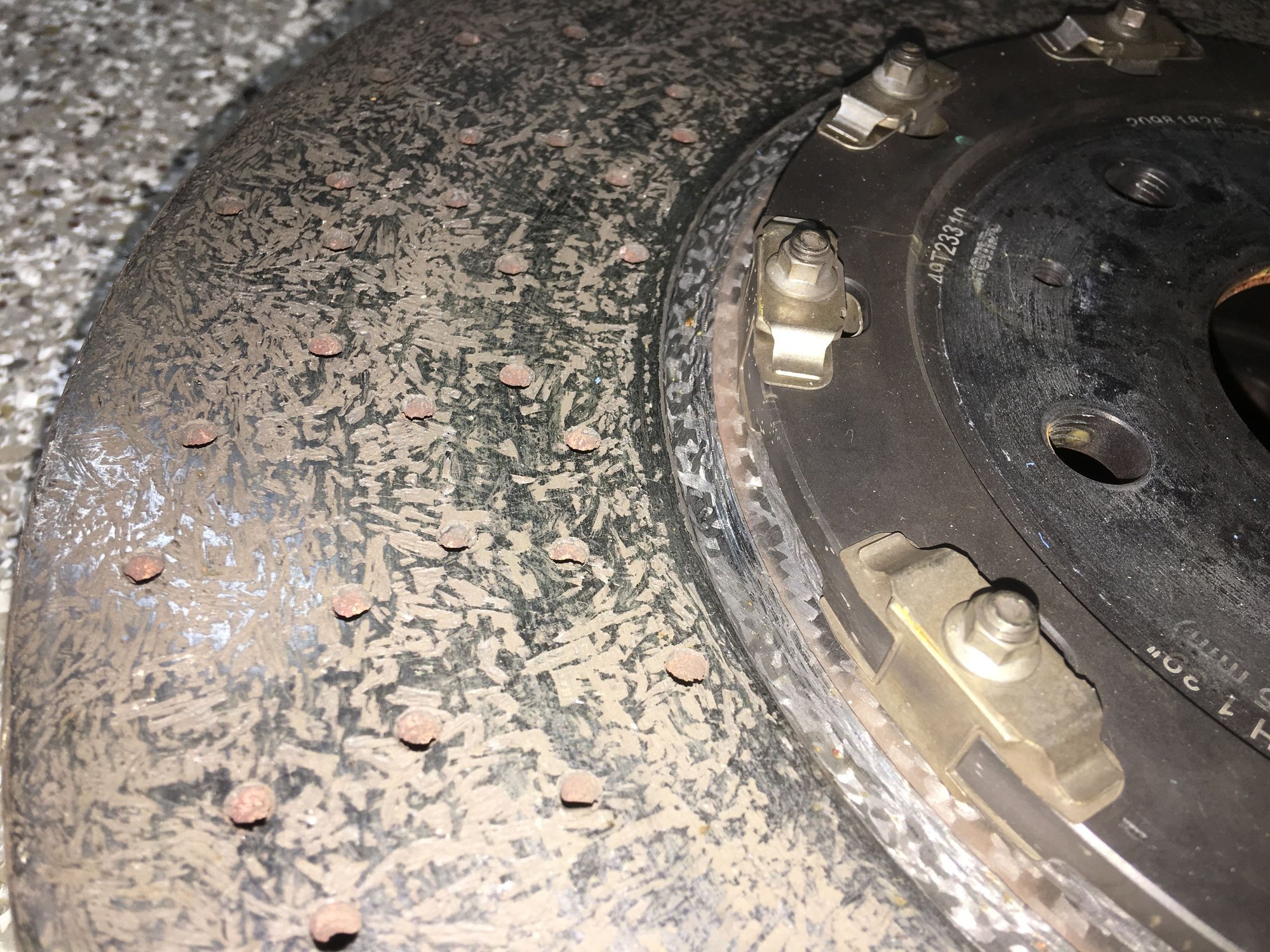

Here is a picture of a rotor that is in the intermediate stages of pock marking. There are some pictures on the forum that are much worse.
Since the rotors are Ceramic the edges of the pock marks are very sharp and a large number of them will increase pad wear. This rotor has 13 track days on it and several thousand street miles, it is also above the minimum weight. As the rotor pock marking got worse my pad consumption went from replacing pads after 6 track days to replacing them after 3 days. At ~$500 for a set of pads and ~$1500 for a rotor replacing these parts can be expensive.

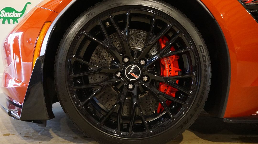

Thanks guys. Bill, does this rotor looking like pocking?

That's a beautiful car !! Tires have been replaced, but with 14K that's about right for these cars. I'm no expert at all on the CC rotors but I've seen some pics here on the forum of tracked-out CC's. Those look almost new to me. As Bill mentioned above they are very expensive to replace, but with just normal street use they say they last pretty much the life of the car. (other forum members W/CC's)
