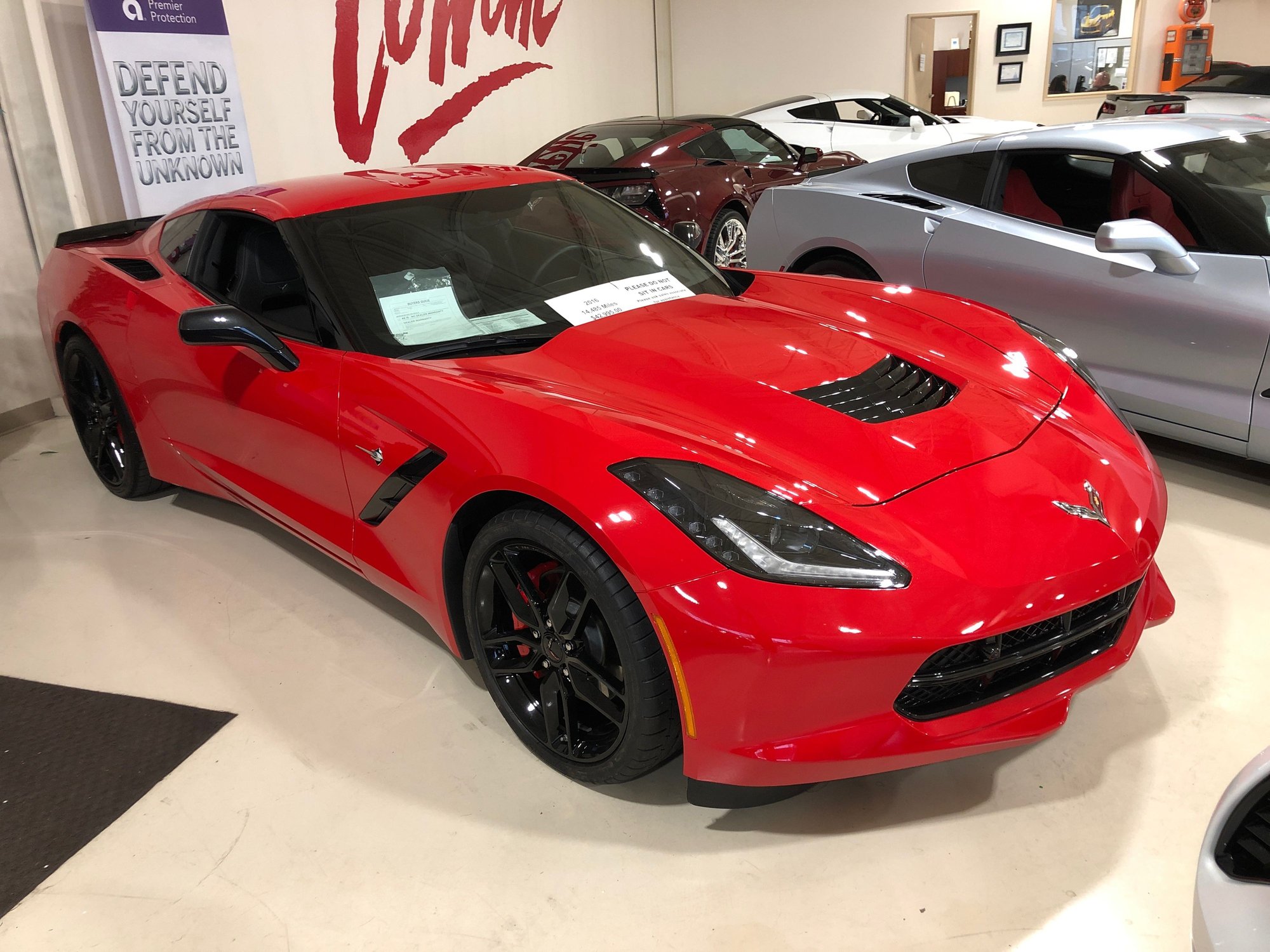

Hey again!
As many of you all know, I just bought my first c7 corvette stingray 2lt ZF1 and I’m wanting to know what sounds, rattles, squeaks and all of the above noises that car makes that are normal. Never owning a corvette before I want to make sure that nothing is unordinary it still has a year left of powertrain warranty on it too

Congrats and welcome as an OWNER instead of a STALKER!
Things that are normal for the C7 and have been topics on the forum
  • The "ackerman effect" causes tire hop when the tires are cold and a sharp turn is attempted at low speeds.
    • From the manual:
      • Tire Chatter/Hop - When driving at slow speeds and in very tight turns, the vehicle may have tire chatter/hop. This condition is normal and the vehicle does not require service.
  • The idle has a slight roughness that is normal. I consider it performance waiting to get out
  • There is a slight ticking from the engine compartment when the engine is running... Attributed to the fuel injectors
  • Road noise can be a bit overwhelming for new owners coming from quiet touring cars. The intensity depends on road surface and is quite noticeable on rough roads but butter smooth on good pavement. A common quick fix is to install Block It mats especially in the rear cargo area as that surface behaves much like a drum head bouncing noise off the rear window to the front seats. The Block It mats do not diminish direct road noise but do cut down the thumping from the back.
  • Others have gone full Monty with sound deadening mats over most of the interior.
As far as cabin noises, it's a bit of a crap shoot.
  • My '17 was absolutely squeak and rattle free with both the carbon fiber top and the transparent roof installed.
  • I am chasing down annoying squeaks and rattles on my '19 from the rear/outer roof areas a couple in the door jamb area...
  • Apparently there are small differences in frame dimensions in different years.
Enjoy!
