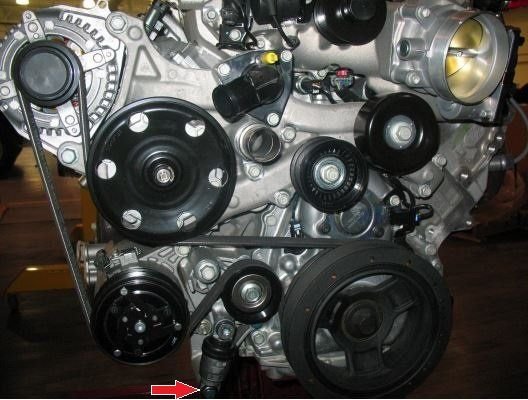

If it happens at 30-40 mph with slight acceleration it could be the tensioner for the serpentine belt. See if there is any oil residue on the damping cylinder. A slight vibration from the V8-V4 shift can cause the seal on the damping cylinder to leak and when the oil is gone there is no cushion for the spring and parts inside of it. That could be the rattle you hear.
It was discussed on here quite a bit a while back and was the source of my noise. Replacement of the part and the addition of a Range Device to prevent the change to V4 solved it for me.
Here is a pic from a previous discussion showing the culprit.
Sounds like that could be the issue. I did notice a link between when it shifted from V8 to V4 and back.
What was the approximate cost for you to get it fixed?
