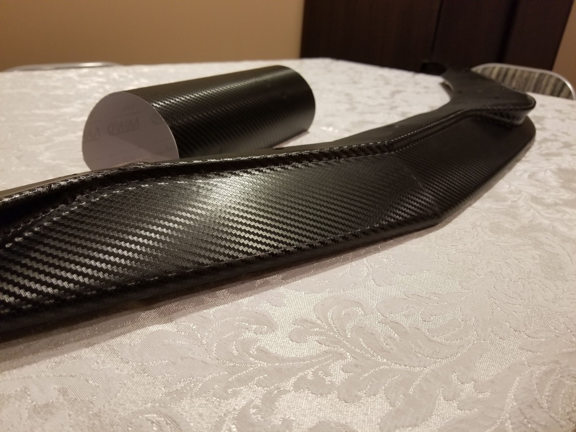

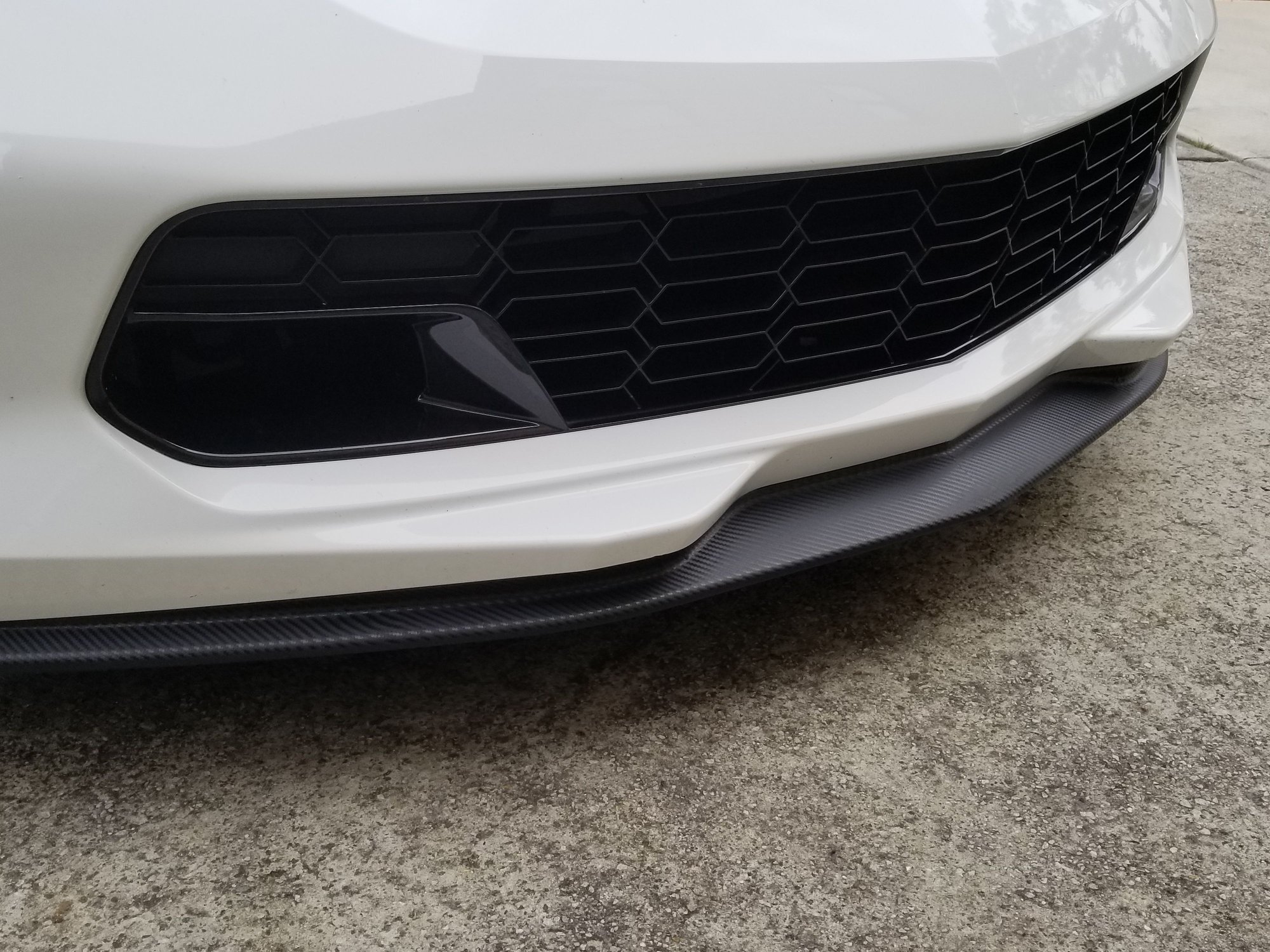

Amazon has loads of it . I did get a big sheet as at first I did not know how much it would take and I wanted to try and do it in one piece... well that won't happen as there is to much pulling and stretching because of all the curves .
So I did it in two pieces a right side and a left side . I made sure to line up the "grain" of the carbon fiber and put the seam right at the centerline, working back towards the sides . Make sure you over lap it on both sides by just an 1/8 th of an inch in the center . Then use a razor blade and run it right down the center and remove the small overlap on each side , bingo a perfect seam . . One mistake I did do the first time was pull the wrap to tight and it lifted out of that inside curve after I installed it . Had to hit it with the heat gun a few times
Never wrapped anything in my life so I was kinda proud of how good it came out for about 7 bucks worth of wrap and about two hours of time

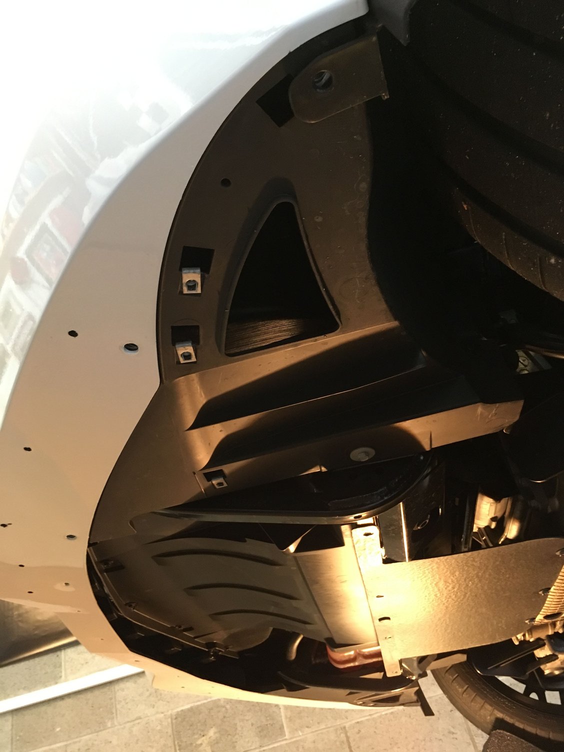

This is what I used, along w/the OEM screws, when replacing my “poverty” splitter with the stage 2/3, which is very solid. Note: the other pieces are the OEM rivets that I drilled out.
