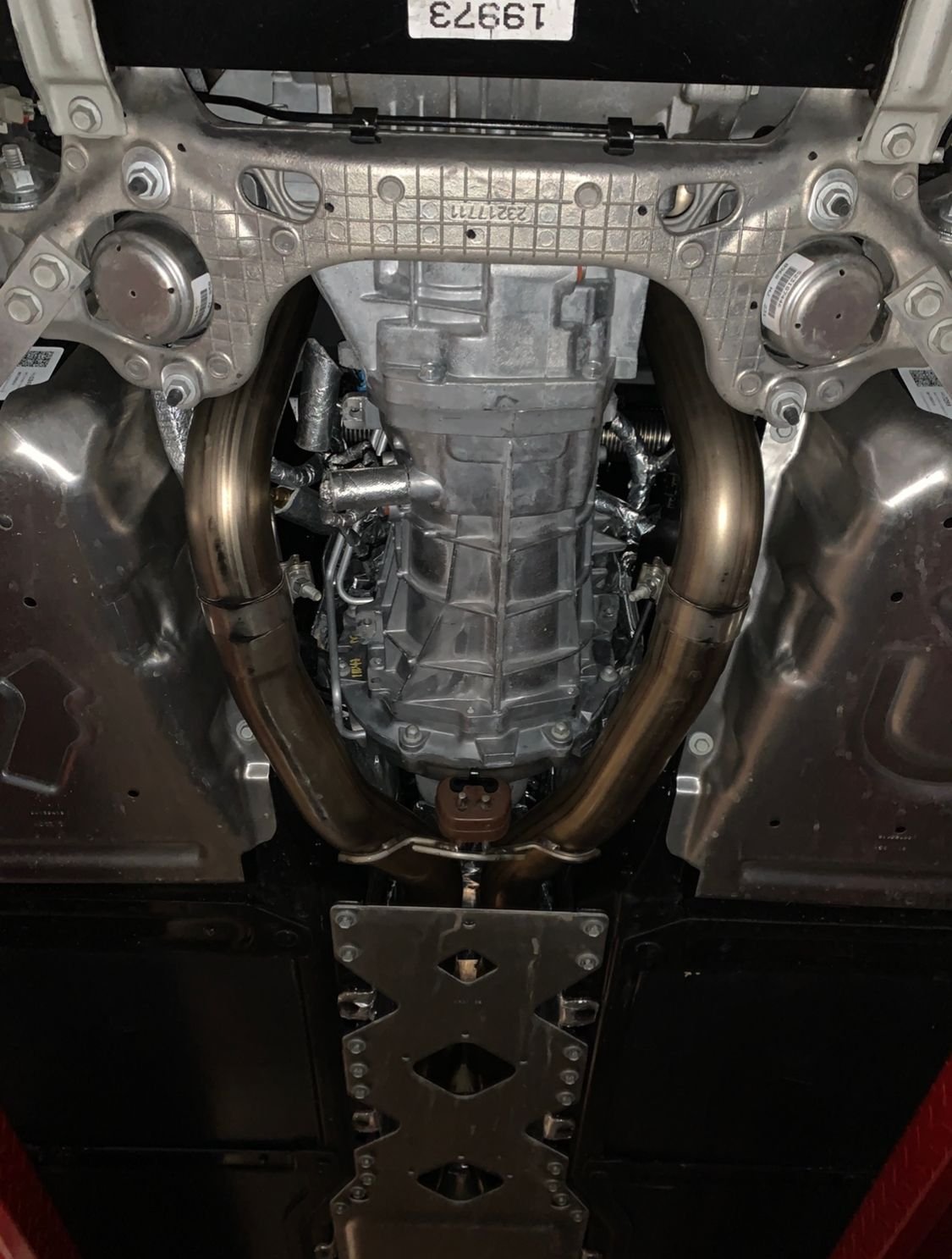

An unrelated question (but don't want to clutter up the board with my pedantic questions) - has anyone seen two small water/oil puddles under their car (see picture), about halfway back, looks to be about centered side-to-side? The picture doesn't show it well, but the darker parts in the middle look like an oil of some sort, but it's not thick enough to be motor oil. It may be AC condensate, but coming from two different areas, and with dark oily stuff in it?

The water spots are probably from the exhaust. Condensation, along with soot, can build-up and drain between at the exhaust clamps. My Z06 will occasionally do this, and my clamps could not get any tighter. I know this because I replaced it... however, I still noticed the same with the OEM set-up. If you take a peek under there with a flashlight, you’ll probably see the source. If this is the case, then there’s nothing to worry about. Nonetheless, you still could try tightening the clamps, which can come loose from vibration, as well as expansion and contraction from exhaust heat.
This looks like exhaust soot/water leaking out a little from the xpipe/exhaust connections. That's fairly common. I'll take a pic of under the car to show and confirm (hang on)
Edit:
You can see the black spots on my connections here..
