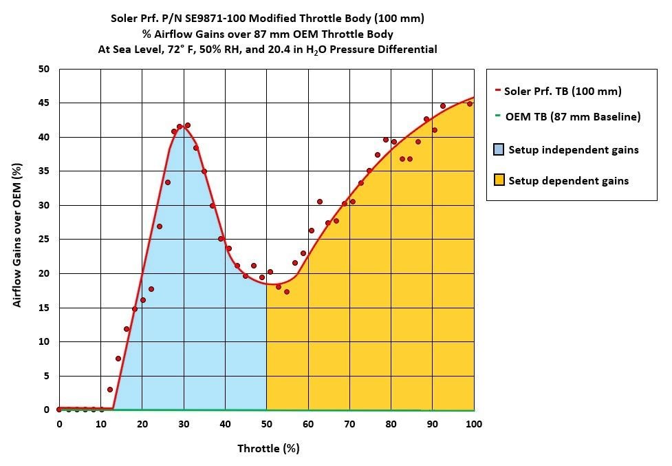

We usually get as many of the competitors TB's we can and test them on the flow bench, not the case with this TB the OP is talking about. I believe this is a 92mm and not 95mm, that is probably why it doesn't need tuning. Maybe the OP can verify.
Having said that, and w/o any data to back it up in this specific case, we can tell you that there is no difference between better response and more power. Having identical pedal maps, a better response is the result of more air or more power for a given amount of throttle. More air -> more power -> more torque -> more acceleration -> feels as better response, as simple as that. They are the same thing.
Test results indicate that up to 50% throttle that amount of air/power is dependent mainly on the throttle body (main restriction, sets flow rate) while at more than 50% throttle the flow rate starts to depend on other components, as it approaches WOT is mostly dependent on the whole system and this is where other mods help. Yes, very difficult to feel it at WOT, but the OP says it is at 50% TP where the difference is felt.
Here are some measurements on our 95mm (100mm Eff.) Throttle Body. What the OP claims with this particular brand and what many of our customers feel is the blue area, which of course, will be different depending on TB brand and size. This is our way to put numbers on the response, it is definitely there and it is the size of an "elephant". Not placebo, so many people can't be wrong.
