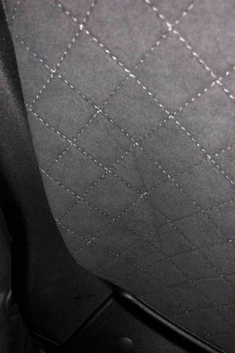

The headliner on my 2015 coupe I starting to fall near the passenger door. Has anyone experienced this and maybe suggest a repair option?

I had the same problem awhile ago. Somewhere there is another thread about this problem. I fixed it by masking off where I didn't want the overspray to go and sprayed both the headliner and the roof. Let both get tacky and press together. I used 3m 777 but I would think that any good interior glue would work.

I agree. If you are careful spraying the adhesive so it doesn't get on things you don't want it on that should work. Once you press the loose piece back in place you may need to use a roller to make sure it is making good contact with the adhesive.
An automotive upholstery shop can probably fix the problem for not too high of a charge. They might be able to do on a drive in, drive out basis after first taking a look at what needs to be done.

Had this happen on my 14. Depending on severity you could careful pull back the area and use brush-able contact cement or in my case it was a larger issue so I removed the whole headliner, masked everything off and used heavy duty 3M spray adhesive. its held up for a year in Florida heat. They must use the same glue as they do on the leather dash

The corners on my 17 were loose so I sprayed them with the 3M adhesive and it worked like a champ. Easy to do and not worth a trip to the dealer. With blue tape and adhesive in hand no more than 30 minutes.
