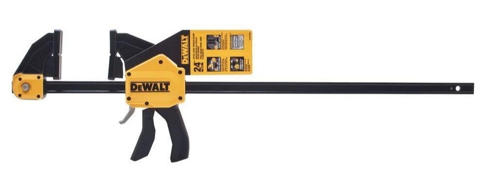

Yes I did it with the Michelin OEM Run Flats that came on my 2018 Stingray as well as with the RE71Rs I put on the car. Sidewall stiffness of run flats is not much different from the RE71Rs. I used DeWalt woodworking clamps to compress the sidewall away from the rim for access to the sensor. I think tire shops have a special clamp to do the same thing.

I suggest buying 4 of the clamps I mentioned. They make changing low profile tires easy. You use them around the tire to keep the bead under the lip of the wheel. They also come in handy when changing TPMS sensors! Without them, you will struggle on your tire changer with Corvette tires and other high performance low profile tires. Make sure you get the "600 lb" heavy duty clamps. Less capable clamps won't get the job done.
