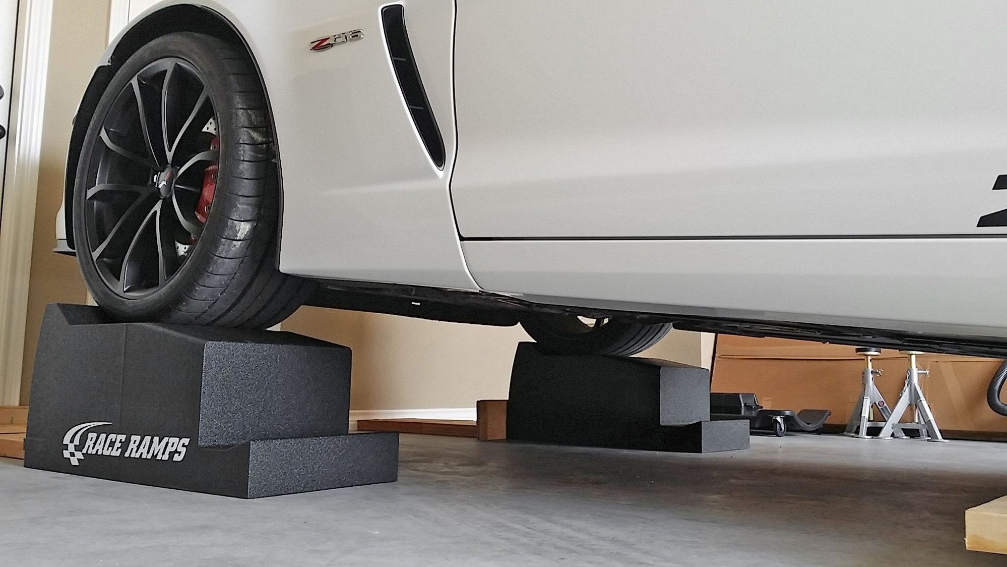

I bought mine from Fred at Reverse Logic on sale and got a pretty good deal at that time. However, I bought the tallest set and did not realize I would need the "Extenders."
The set I purchased did not allow a safe approach without the use of 2 x 10 planks. It was cheaper to buy them than the "Extenders" after the fact.
Once my 2013 C6 Z06 is up on the race Ramps, you can remove the ramp itself while the vehicle sits snug up on the race Ramp blocks.

Wow, thats a nice set up. With all the talk about screwed up oil changes at dealerships I believe I want to do my Z51 myself. Impressive and a lot of room to crawl under especially for old guys like me. Thank you.
Wow that is a nice set up. Lots of room to get under the car especially for old guys like me. Thank you sir.

I have them and they work great. You need the longer ramped one which I believe are 72" that has a more gradual incline ramp. I also got the 3" ramps for the rear tires and do my oil changes on a slight slope to get the car level. I forgot how much they are, but I believe I ordered mine from Race Ramps. And you need the wheel chocks for safety. Makes for an expensive first oil change. The are very light and easy to manage. The one challenge I found is getting the four ramps setup properly so all wheels go in the right position at the same time. Take some measuring and practice.
