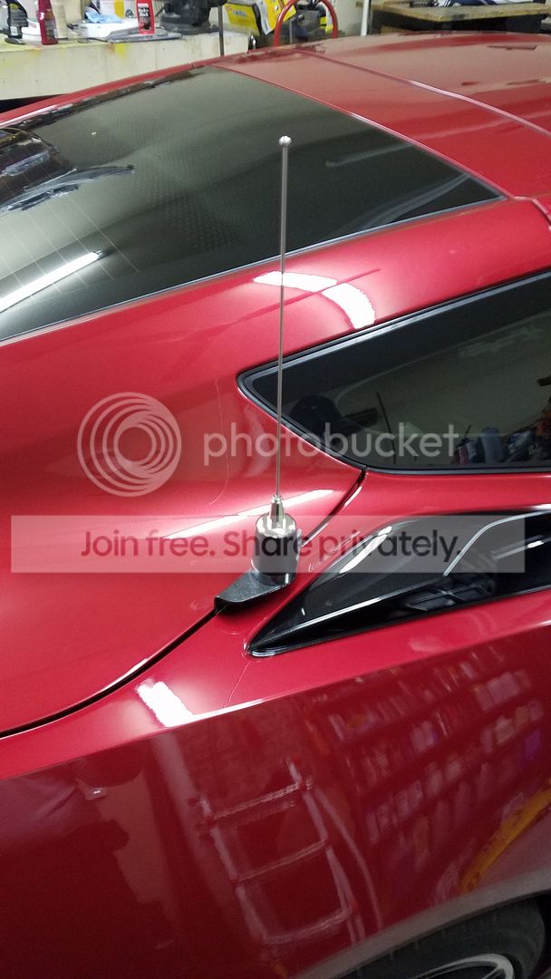

This is my mount I made for my car.....currently showing my 1/4 wave base load for normal travel when I don't need long range reception. The 1/4 wave will tend to keep the signal flatter (on the ground) than my 5/8 Tram center load antenna. The 5/8 will pull in voice that people next to me are not hearing at all.....works super for long convoys; down side, it tends to whistles at freeway speeds. I also (for what it's worth) built a ground plane using 3/4" braided ground strap around the back window grounding the antenna base and also connected to Battery Ground. I know in theory one can get away without a ground plane on UHF but because I also can use the same mount for my Fire-stick (CB antenna), it does help cover the lower freqs.
Don't worry about 35 Watts reacting to the rear of your car; that isn't enough power to cause any damage at all....now 35K watts, different story. My mobile will go up to 50 watts but I have never needed to run more than 10 watts. If we get too many hills where we start to loose line-or-sight between lead car and drag, or close to it, it doesn't really matter how much power you have, that's were repeaters come into play. Years ago when out off-roading in the mountains I would take two of my handhelds and set them up as a repeater.....worked quite well when running a group up a long canyon with a lot of wench points.
BTW, I would get your antenna up a little higher to clear the metal in the rear of your car.....as is, you are getting some reflection off back end so your signal will tend to cover more to the rear than the front of your car.
Someone above made a comment about holding a Ham Licence; just to be clear, a Ham Licence does not cover FRS/GMRS frequency's, to run more then the 2 watts on FRS channels, a licence is available for $75 with no test needed. I doubt if very many people really hold one that are using higher power.....and as long as you are not a bucket mouth and tie up the channel, most likely you will never be tagged.
1/4 wave? Never heard of a base loaded 1/4 wave before. If that's UHF, that is not a 1/4 wave

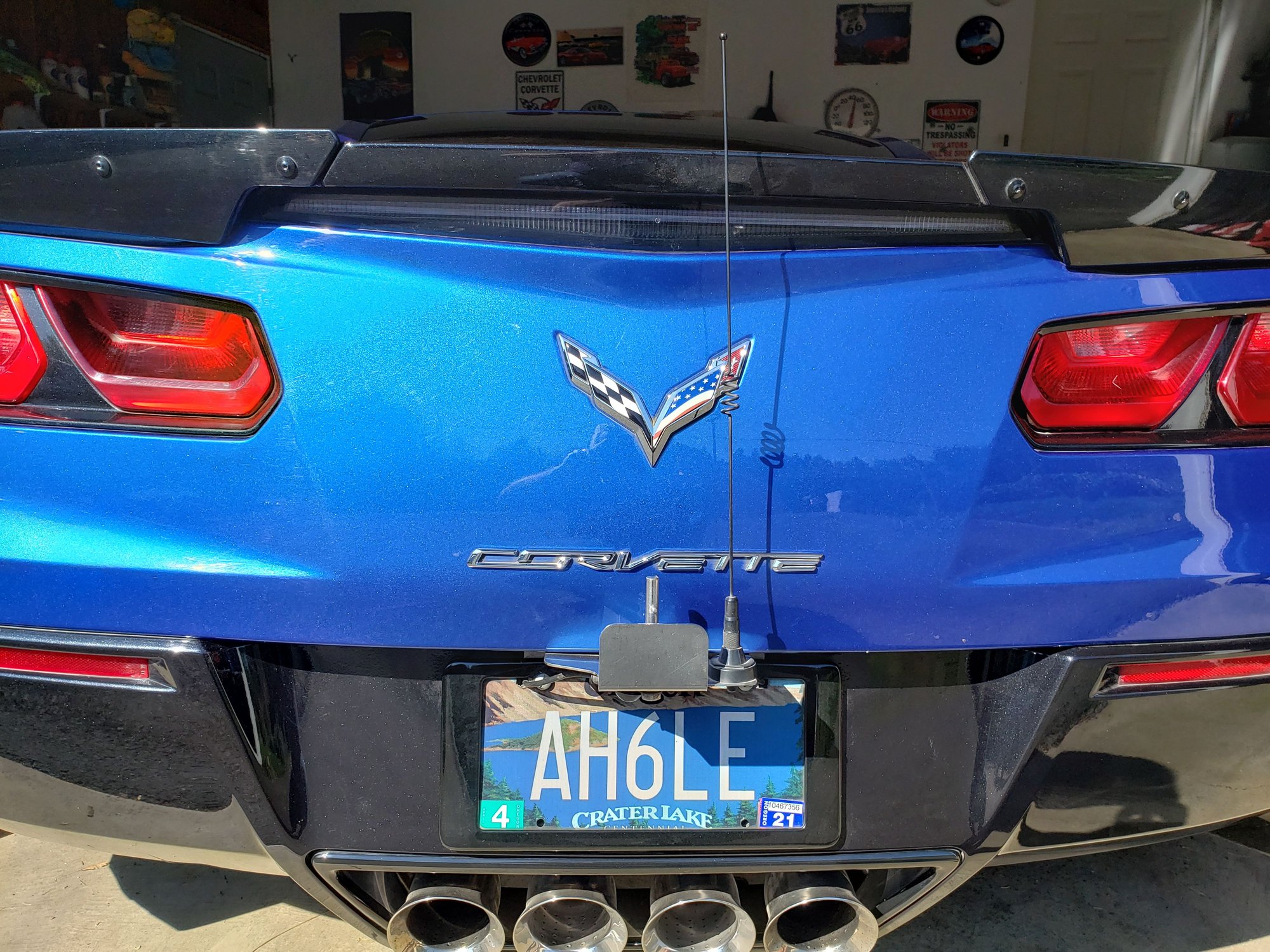

We are using channel 7 or 462.7125 MHz. I also have a convertible. CB, channel 19 is 27.185 MHz.
I wonder if something like this would work better than my license plate bracket?
https://www.amazon.com/Browning-450MHz-470MHz-3dBd-Mobile-Antenna/dp/B00IDTJ2EA/ref=sxbs_sxwds-stvp?crid=NY2U6TP6GBPN&cv_ct_cx=browning+br450&dchild=1&keywords=browning+br450&pd_rd_i=B00IDTJ2EA&pd_rd_r=d20494bf-e7f3-4402-92b4-ce5874bc21b3&pd_rd_w=WQHLY&pd_rd_wg=BTjqW&pf_rd_p=183579a1-f0e6-4556-8e39-8fe08e8f8141&pf_rd_r=XHH1QBFAR41WN29H0PB9&psc=1&qid=1587546194&sprefix=Browning+br450%2Caps%2C166&sr=1-5-dd5817a1-1ba7-46c2-8996-f96e7b0f409c https://www.amazon.com/Browning-450MHz-470MHz-3dBd-Mobile-Antenna/dp/B00IDTJ2EA/ref=sxbs_sxwds-stvp?crid=NY2U6TP6GBPN&cv_ct_cx=browning+br450&dchild=1&keywords=browning+br450&pd_rd_i=B00IDTJ2EA&pd_rd_r=d20494bf-e7f3-4402-92b4-ce5874bc21b3&pd_rd_w=WQHLY&pd_rd_wg=BTjqW&pf_rd_p=183579a1-f0e6-4556-8e39-8fe08e8f8141&pf_rd_r=XHH1QBFAR41WN29H0PB9&psc=1&qid=1587546194&sprefix=Browning+br450%2Caps%2C166&sr=1-5-dd5817a1-1ba7-46c2-8996-f96e7b0f409c
Problem is, how do I mount it on a convertible?
