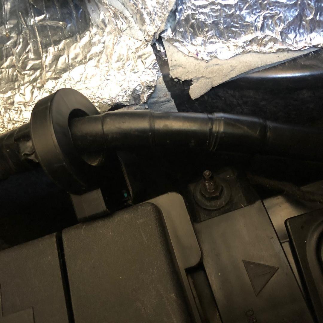

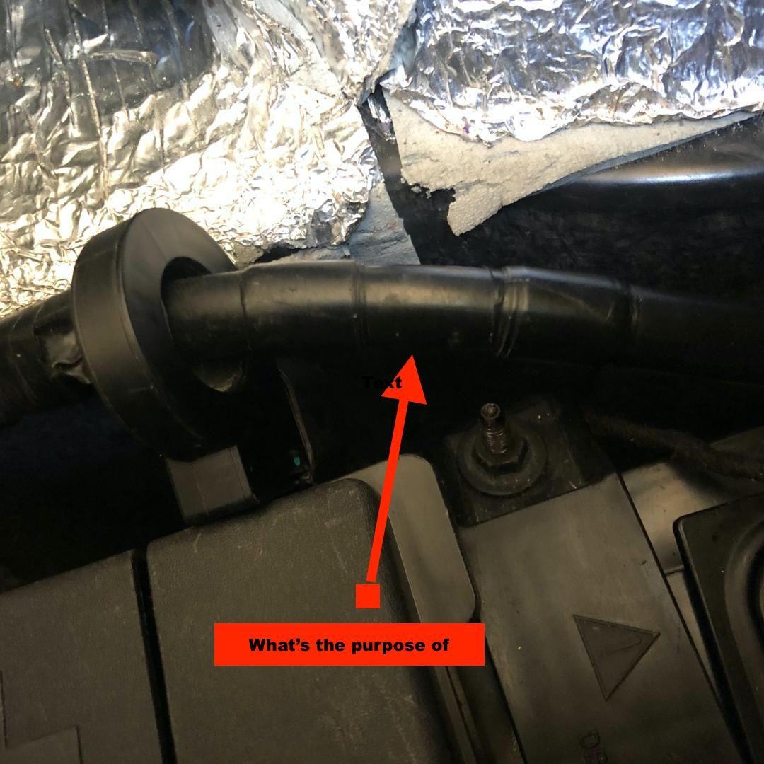

The Current sensor on the negative battery cable tape has come loose and the current sensor has moved from its original location. Does it matter where I re-tape it on the ground cable? I know it measure battery current going in and out and sends it to the BCM. The Ground cable has what looks to be a place for it, but I can't get it there due to the tie down bracket. I could probably loosen the battery tie down and move the battery slightly aft to make room if that's indeed where it needs to go.
Also is there supposed to be some sort of battery tray? I just replace my battery and it did not have one. Battery sitting right on the composite.

The position does not matter, as long as the wire passes thru the hole......
