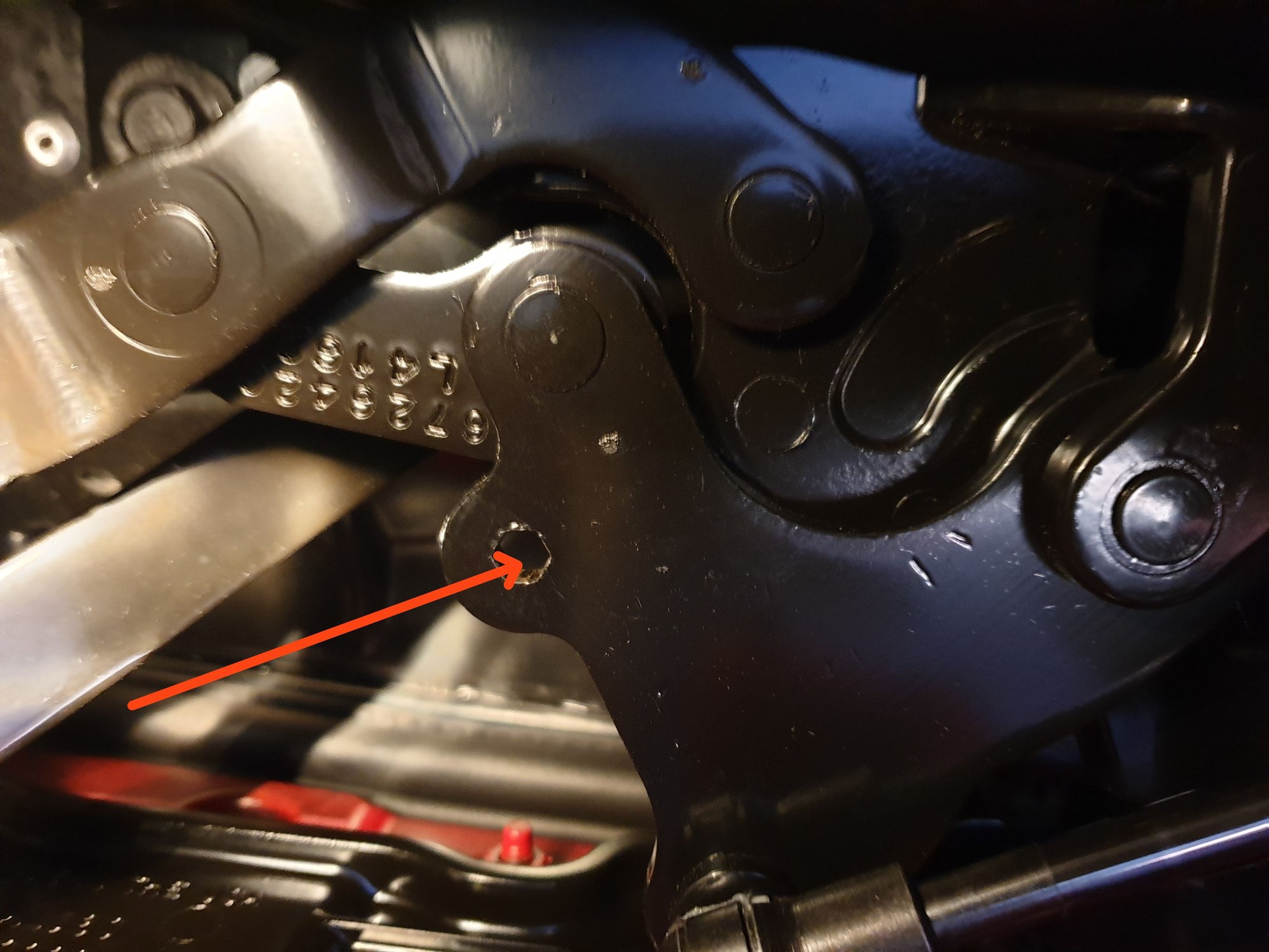

Default C7 convertible roof problem
Hi. Good news ! Managed to get the roof stowed OK. The roof had got to locked on the front windshield with the rear floating body panel (that covers the roof stowage compartment) locked down in place but the soft rear of the roof with the rear window in had not locked down onto the black body strip.
Inside the trunk you can get to the mechanism each side that operates the rear floating body panel. There is a hexagonal hole in one of the arms that will take an Allen key (see picture).
Insert and pull the Allen key stem (might need an extension on it to get the leverage needed) towards the back of the car. This will release the locking mechanisms for the floating body panels on each side and enable the panel to be moved backwards manually to expose the stowage compartment. I then raised the rear window into the upright open position and pressed the switch to power down the roof and it all happened fine !! Don't know whether I will get a problem when I try to close it !! I'll keep you all posted.
Many thanks for the suggestions submitted.
