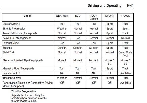

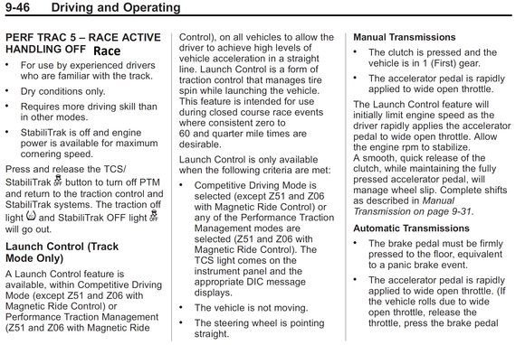

Since it’s a non Z51 car, it does not have Performance Traction Management. But it still has Competitive Driving setting within the Track mode. And launch control can be used there. To be honest, I don’t know how you engage Competitive Driving. Of course you turn the **** until you’re in track mode. But I don’t know if it’s a single long press of the traction button or two quick pushes like how it is to engage the PTM. Well, here’s the section of the owners manual.

In vehicles equipped with Performance Traction Management (PTM), the Competitive Driving Mode is only available in Sport Mode.
In vehicles not equipped with PTM (such as a a non Z51 car), the Competitive Driving Mode is available in Sport and Track Mode.
Then quickly pressing on the center console two times. STABILITRAK COMPETITIVE MODE displays in the Driver Information Center.
Is it different between the years? Not sure what year this manual is from but it very much says that you have to be in Track only to engage Competitive Driving or PTM and enter launch control.
It certainly may be. The information I posted is from the 2018 manual.
Just took my 2019 out a couple hours ago and tried every which way to find Competitive Driving in Sport...nope. All I can get is PTM in Track.
Interesting.
My 2018 Z06 will go into Competitive Driving Mode in Sport, and Performance Traction Management in Track.

lostsoul's Avatar
lostsoul
Banned Scam/Spammer
Joined: Apr 2016
Posts: 5,951
Likes: 952
From: Stockton, ca
my 2016 z51 wo/PTM - shows competitive with the double click in Track but in sports it doesn't say it, but after trying a few times I was able to see Traction and Stable lights turn on.
