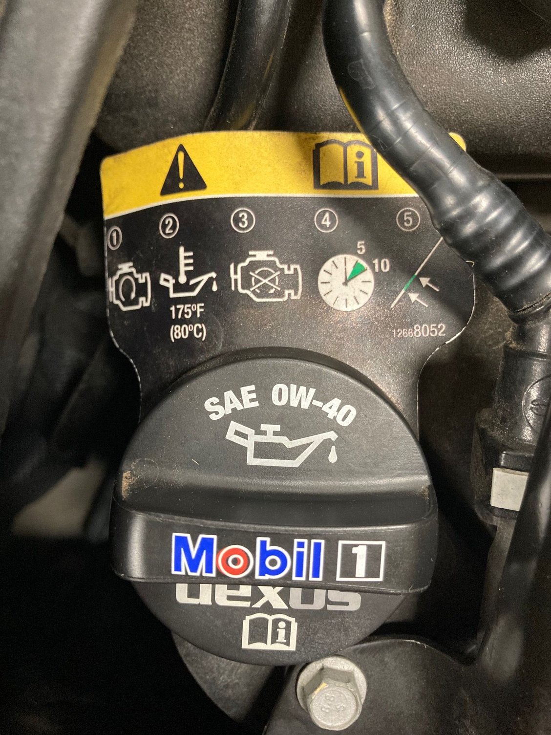

Old Jan 30, 2021 | 08:57 PM
Gearhead Jim's Avatar
Gearhead Jim
Joined: Sep 2000
Posts: 25,002
Likes: 2,703
From: Far NW 'burbs of Chicago
St. Jude Donor '13
Originally Posted by RobRobinette
Chevrolet knew what it was saying when it said warm the engine to 175 degrees F. They meant water temp and 175 is all you need to accurately check the oil. I keep mine between the middle and top dots.
The Owner Manual on our 2017 Z51 doesn't seem to specify whether they want 175 oil or 175 water. Oil temp makes more sense, since you are measuring the oil.
Here's a picture of the factory label on our 2017 Z51 and it clearly shows the symbol for oil temp.
Old Jan 31, 2021 | 09:24 AM
davanz's Avatar
davanz
Joined: Mar 2006
Posts: 643
Likes: 70
From: EAST TEXAS
Look at the picture in Gearhead Jim’s post. The symbol at step 2 is of the oil temp, same as in the instrument cluster readout.
