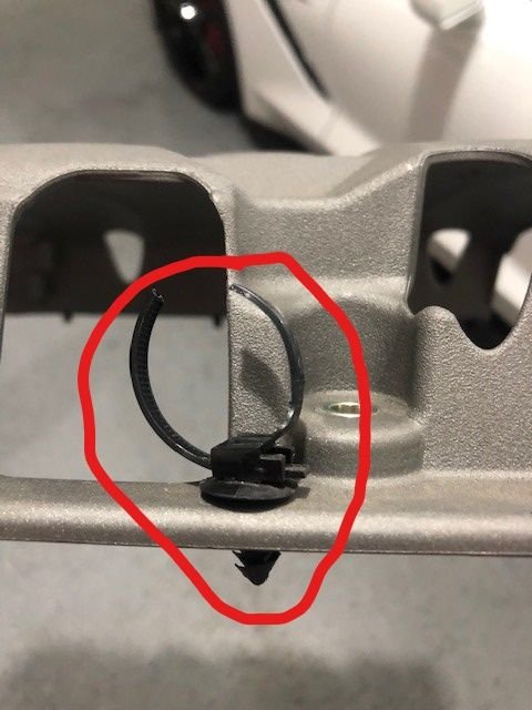

I am looking for a new set of Zip Tie standoffs that are on the engine plenum cover (circled in red in the attached pics) can anyone point me in the right direction where I can get some or maybe a part number. There are two each of the tall standoffs and four each of the short standoffs. Thanks for your help!

I just went through this -- there is a solution that costs next to $0, and is better than the original.
Find some zip ties that are the same width as the width long portion of the original, "captive" zip ties that were part of these parts.
Then, on your car / just like in the picture,
remove the free part of the zip tie (just pull it out, in the correct direction), and cut the other, captive end of the zip tie as per the picture I've attached.
Now, with all of the remnant of the zip tie removed from the "post", you can thread a new zip tie into the post, and then use the zip tie as normal. Next time you take the cover off, you just cut and pull the new zip ties off, but you still keep the old "posts" that are captively attached to the engine cover. So, infinite reusability moving forward.
Sorry, I don't have any images of this on my car (it's all buttoned up).
TL, DR: by cutting off the captive, single-use zip tie of this kind of post, you can re-use the original GM part as a "post only", along with a replaceable aftermarket zip tie that is captured by the post.

Thanks for the reply! I will do just that!

I just did this - you do not have to replace them as long as the bottom (threaded section) is still intact. Watch this video - he shows you exactly what to do at 1:55 in the video:

AEK is spot on with his advice. I did exactly what he mentions when I installed my painted plenum cover. The zip ties work great to secure the wire looms.

Hi! Guys,
It is kind of too late for me to do the zip tie trick. :-(
One or two of these have broken off during removal.
Does anybody know the P/Ns to order replacements?

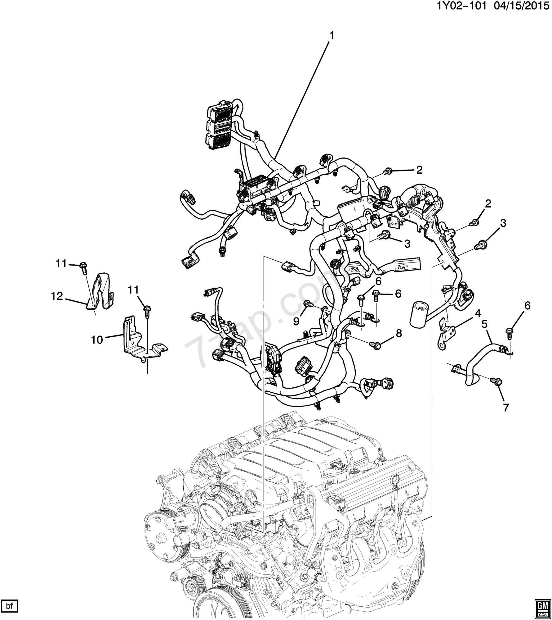

I think they are in this picture but unfortunately the parts list doesnt break them out by number

Yes, I found the harness, but there is no break down! :-(
